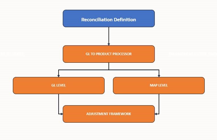

The General Ledger to Product Processor is the predefined reconciliation definition type that can be used during a Reconciliation Definition. The reconciliations are defined, which forms a part of execution and data verification. This can be defined as Manual Reconciliation Definition, as shown in below Figure.
This reconciliation type is defined in the Reconciliation Rule UI. Product Processor is an entity in the DFCS System used to store data that are received from the Operational System of the Bank.

Figure 5-2 Balance Reconciliation Rule for General Ledger to Product Processor Workflow
This image displays the Balance Reconciliation Rule for General Ledger to Product Processor Workflow
