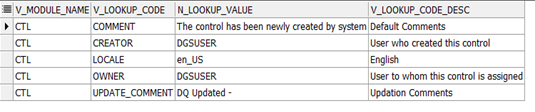

  1. For control creation, first you must seed the FSI_DGS_CONFIGURATION table.
    In the N_LOOKUP_VALUE column, you can modify the values in the CREATOR and the OWNER fields.
    Figure 10-1 Control Creation through Batches
    This illustration shows the N_LOOKUP_VALUE column details.
