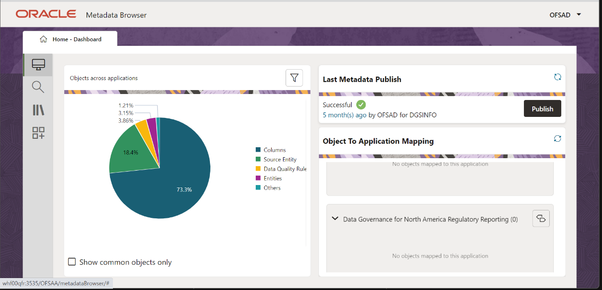

- MDB Publish: To publish the MDB, follow these steps:
- Log in to Oracle Financial Services Analytical Applications interface with your credentials.
- From the LHS Menu, click Financial Services Data Foundation, and then click Metadata Browser.
- Click the Publish button on the Metadata Browser
screen.
Figure 17-1 Metadata Browser
- Click OK.
- Click the Refresh button to view the latest status.
