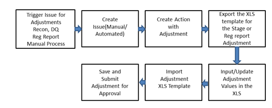

The Data Adjustment process is illustrated in the following diagram:
Figure 13-1 Data Adjustment Process
- The issue is triggered for adjustments.
- An issue is created.
- An action is created with the adjustment.
- The adjustment is configured and the template for the stage or the regulatory reporting template is exported.
- The Excel template is updated with the required inputs.
- The adjustment is then imported.
- The adjustment is saved and submitted for approval to the Data Adjustment Approver.
