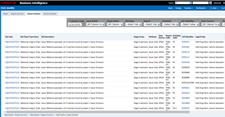

The enhanced Data Quality Control functionality analyzes the impact of Data Quality failure on Regulatory Reporting based on Data Source. The report helps analyze the impact of Data Quality failure on a Cell value, and there is an option to drill down to account granularity to identify failed accounts. The analysis provides a Dashboard, Summary report, and Data Quality drill down report.
The following are the reports provided under Impact Summary.

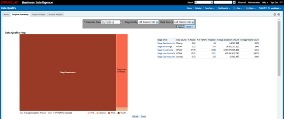

  • Impact Summary – Data Quality Impact Detail
  • Click the Data Quality Map or the Stage Entity, to view the Impact Analysis.
Figure 16-13 Impact Summary
This illustration displays the enhanced Data Quality Control functionality which analyzes the impact of Data Quality failure on Regulatory Reporting based on Data Source. The report helps analyze the impact of Data Quality failure on a Cell value, and there is an option to drill down to account granularity to identify failed accounts. the Dimension Table.

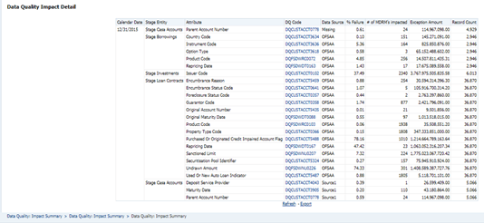

Or, click the DQ Code under Data Quality Impact Detail to view the Impact Analysis.
Figure 16-14 Data Quality Impact Detail

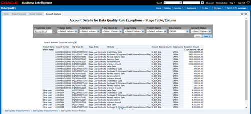

Account Analysis Drill-Down Report: Click the DQ Code link in Impact Analysis to view the Account Analysis Report. This report displays the Account Number associated and the Exception Amount for the Account Balance based on the Data Source.
Figure 16-16 Account Analysis
This illustration displays the Account Number associated and the Exception Amount for the Account Balance based on the Data Source.

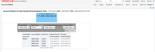

Click the Cell Identifier link in Impact Analysis to view the Cell drill-down report.
Figure 16-17 Account Details
