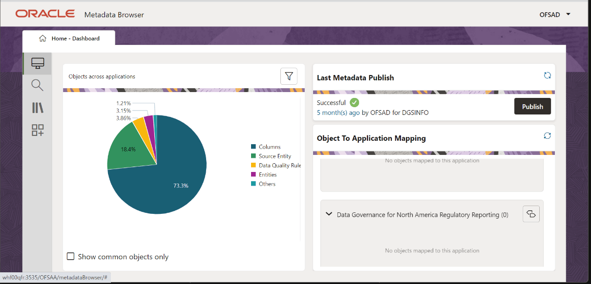

  2. MDB Publish: To publish the MDB, follow these steps:
    1. Log in to Oracle Financial Services Analytical Applications interface with your credentials.
    2. From the LHS Menu, click Financial Services Data Foundation, and then click Metadata Browser.
    3. Click the Publish button on the Metadata Browser screen.
      Figure 17-1 Metadata Browser
      Metadata Browser
    4. Click OK.
    5. Click the Refresh button to view the latest status.
