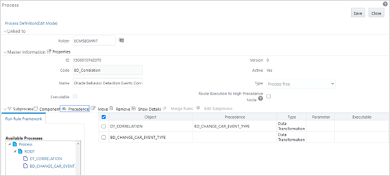

If the batch is run and there is an open CAR Case with the same focal entity, the event type of the upcoming events is changed to AML_CA and is correlated/extended to the CAR case. If the correlation/extension is not occurred,
  • you must add the BD_CHANGE_CAR_EVENT_TYPE Data Transformation (DT) to Oracle Behavior Detection Events Correlation - BD_Correlation process
  • the DT must be in precedence of DT_Correlation. hence the sequence must be:
    • DT_Correlation
    • BD_CHANGE_CAR_EVENT_TYPE
    Figure 20-1 CAR Case Correlation
    This image shows the shows the BD_CHANGE_CAR_EVENT_TYPE precedence.
