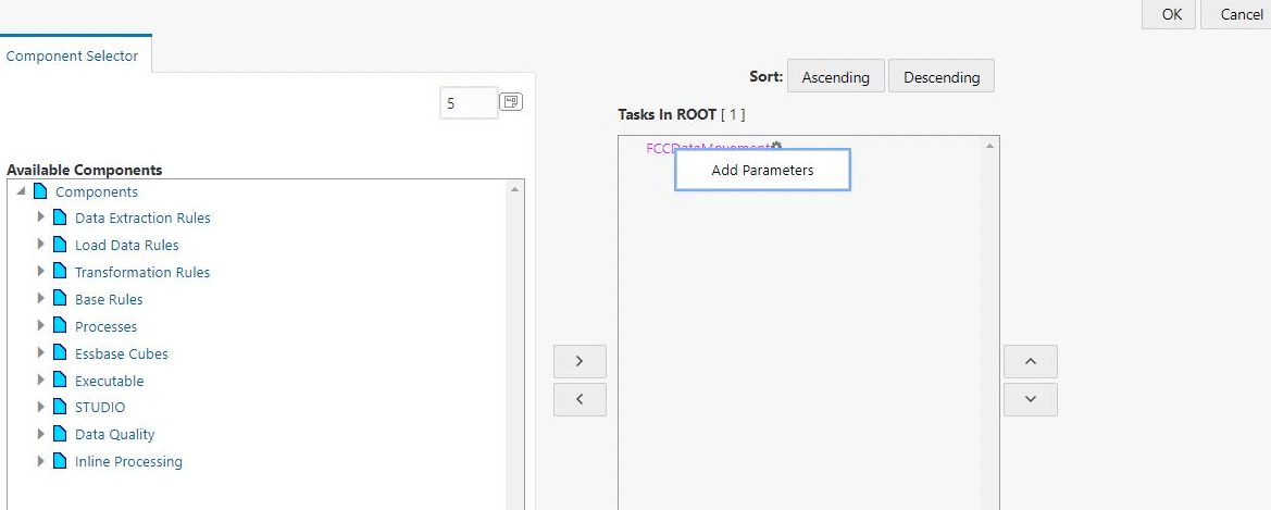

- Click Component.
Figure 7-6 Process Component
- Right-click on FCCData Movement and then click Add
Parameters.
Figure 7-7 FCCData Movement and Add Parameters
- Replace the existing parameter value with:
"SOURCENAME=DAY02","DATAMOVEMENTCODE=BD_CUST_CUST","LOADTYPE=DBLINK","DATAMOVEMENTOPERATION=DDI".
Figure 7-8 Replace Existing Parameters
- Click OK.
- Click Save and then click No when prompted to save a new version.
- The FCC_CUST_CUST table is fully refreshed from the CUST_CUST table during batch execution

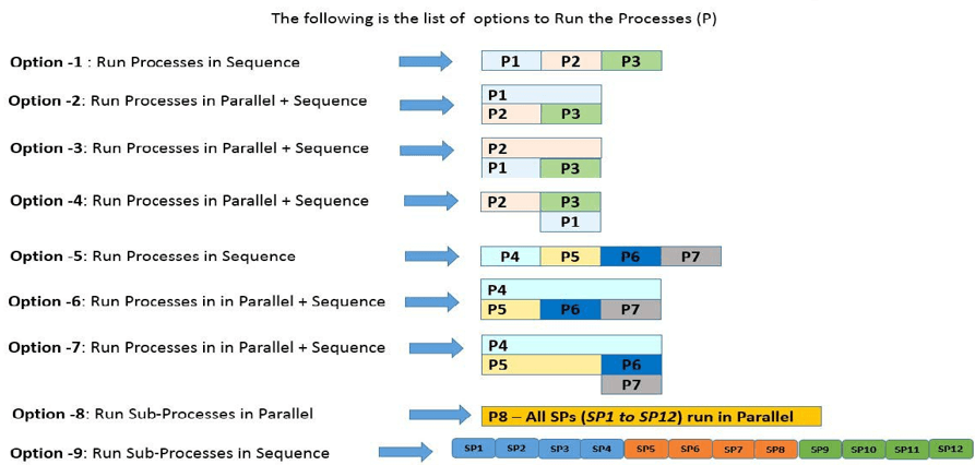

Table 7-6 Options
| Option | Description |
| 1 |
P1, P2, and P3 processes are configured in sequence.
Once P2 is completed, P3 will start and sub-processes SP9, SP10, SP11, and SP12 will run in parallel. |
| 2 |
P1 and P2 will start in parallel and P3 will start only after P2 is completed, irrespective of P1 is completed or not.
Once the P2 is completed, P3 will start and sub-processes SP9, SP10, SP11, and SP12 will run in parallel. |
| 3 |
P2 and P1 will start in parallel and P3 will start only after P1 is completed, irrespective of P2 is completed or not.
Once the P1 is completed, P3 will start and sub-processes SP9, SP10, SP11, and SP12 will run in parallel. |
| 4 |
Only after completion of P2, P3 and P1 will start in parallel.
P3- SP9, SP10, SP11, and SP12, and P1 - SP1, SP2, SP3, and SP4 sub-process will run in parallel only after completion of all sub-processes of P2. |
| 5 |
P4, P5, P6, and P7 processes are configured in sequence. P4 - SP1, SP5, and SP10 will run in parallel.
Once the P6 is completed, P7- SP10, SP11, and SP12 will start in parallel. |
| 6 |
P4 and P5 will start in parallel and P6 will start only after P5 is completed, and followed by P7 irrespective of P4 is completed or not.
Once the P6 is completed, P7 will start and sub-processes SP10, SP11, and SP12 will run in parallel. |
| 7 |
P4 and P5 will start in parallel. P6 and P7 will start in parallel only after P5 is completed, irrespective of P4 is completed or not.
P6- SP6, SP7, SP8, and SP9, and P7 - SP10, SP11, and SP12 sub-process will run in parallel only after completion of all sub-processes of P5. |
| 8 | Once P8 starts, all sub-processes from SP1 to SP12 will run in parallel. |
| 9 | All sub-processes will run in sequence from SP1 to SP12. |
- The same sub-processes should not be part of two processes. For example, you should add P1 and P4 in the same run as they have similar sub-process (SP1).
- The above options are used as samples, you can configure your own options based on the requirement.
