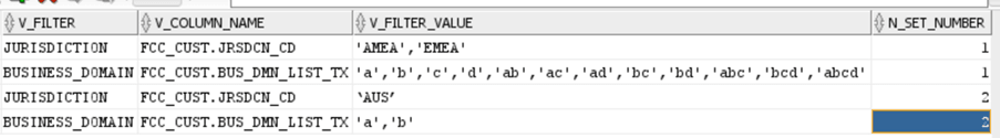

  2. Configure the filter conditions in the FCC_EXT_BATCH_ENT_SCRN_FLTR table based on any column available in the select query specified under the ECM_CUSTOMER property in ECMQuantifindBulkService.properties. Customer entities will be picked up by the Quantifind bulk entity process based on this configuration.
    Currently, only the CUSTOMER entity type is supported. A sample entry for the filter table is shown below.
    Figure 20-39 Sample Customer Entity Entry
    This image shows the Sample Customer Entity Entry.
    To apply default MIS_DATE and DATA_ORIGIN filters with your custom filter conditions, modify the following filter conditions:
    • MIS_DATE: filter_value as $FICMISDATE (the date given in the batch run UI)
    • DATA_ORIGIN: filter_value as $BATCHDATAORIGIN
      The system will automatically take values based on the batchrun id ** from the fcc_batch_run table.
    Different filter sets can be configured based on the N_SET_NUMBER. The filterSetNumber which will be applied must be given in the <<FIC_DB>>/bin/ ECMQuantifindBulkService.sh file (filterSetNumber parameter).
    Currently, only the IN condition is applicable for the filters specified in the FCC_EXT_BATCH_ENT_SCRN_FLTR table. If there is no filterSetNumber configured, then the filter condition of mis_date and data_origin will be appended to the configured ECM_CUSTOMER query.
