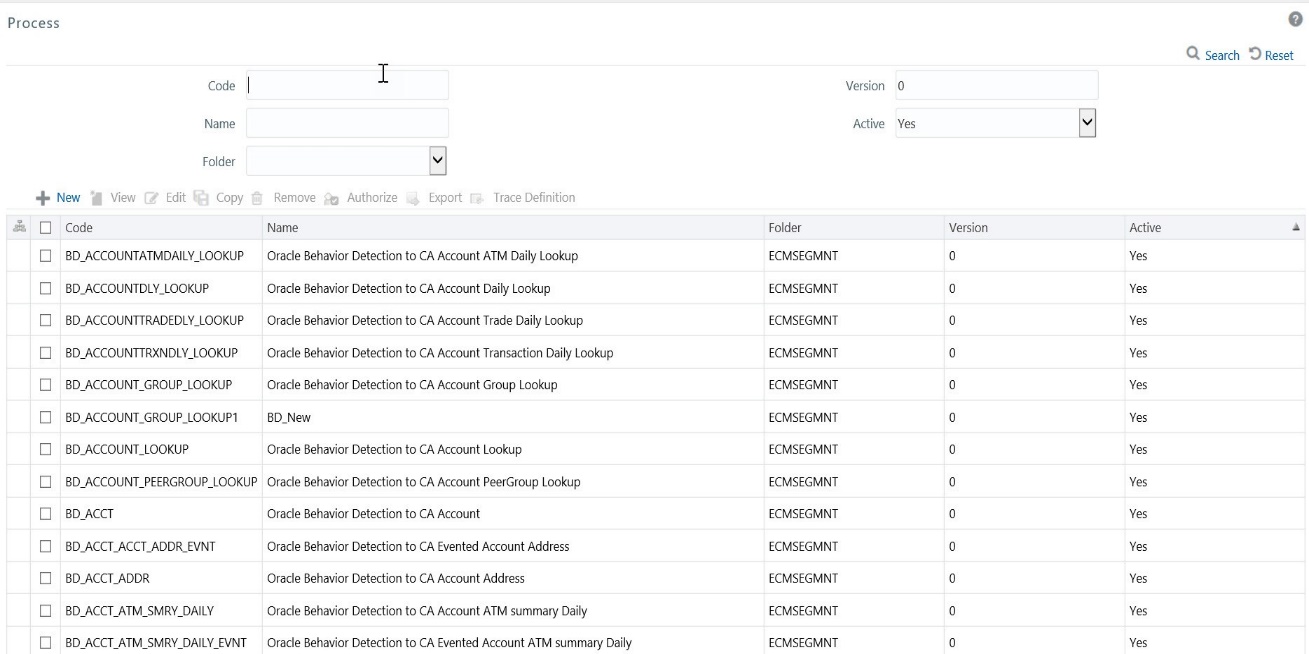

- Click Process. The Process Summary window is displayed with the available
Processes.
Figure 9-3 Process Summary Window

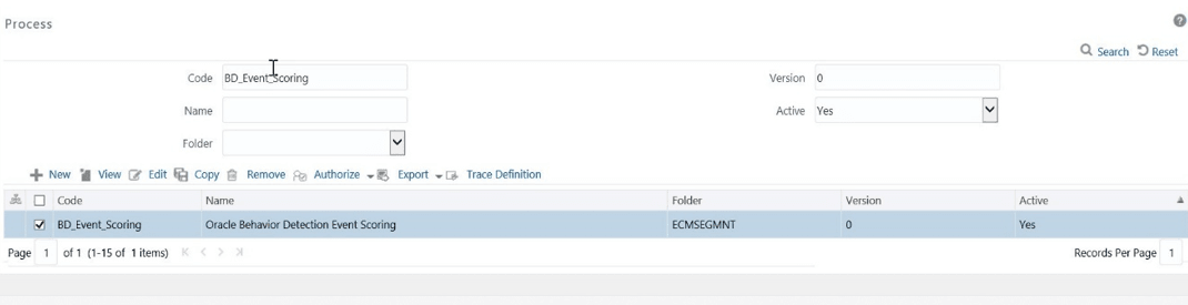

- Search for BD Scoring code. For example: BD_Event_Scoring.
Figure 9-4 BD_Event_Scoring

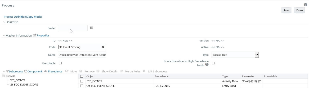

- Click Edit after selecting the BD Event processing. The list of tasks is
displayed.
Figure 9-5 List of Tasks

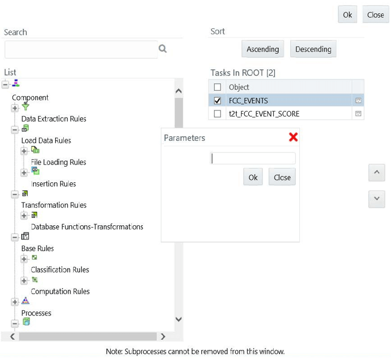

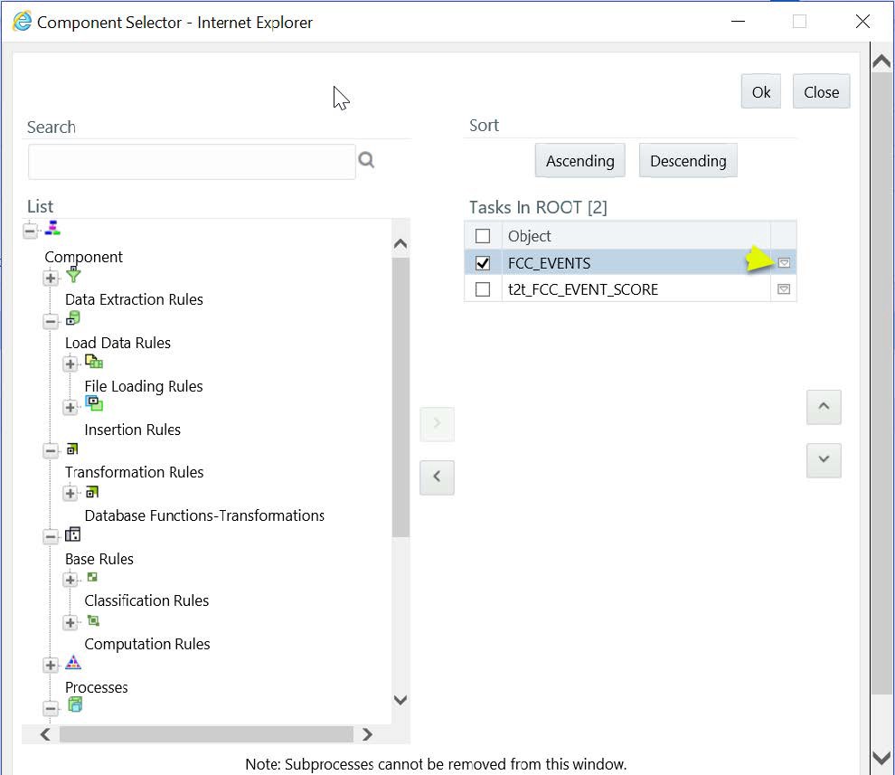

- Click Components.
Figure 9-6 Components
- Delete all the parameters of the FCC_Events task and clickOK.
Figure 9-7 Parameters

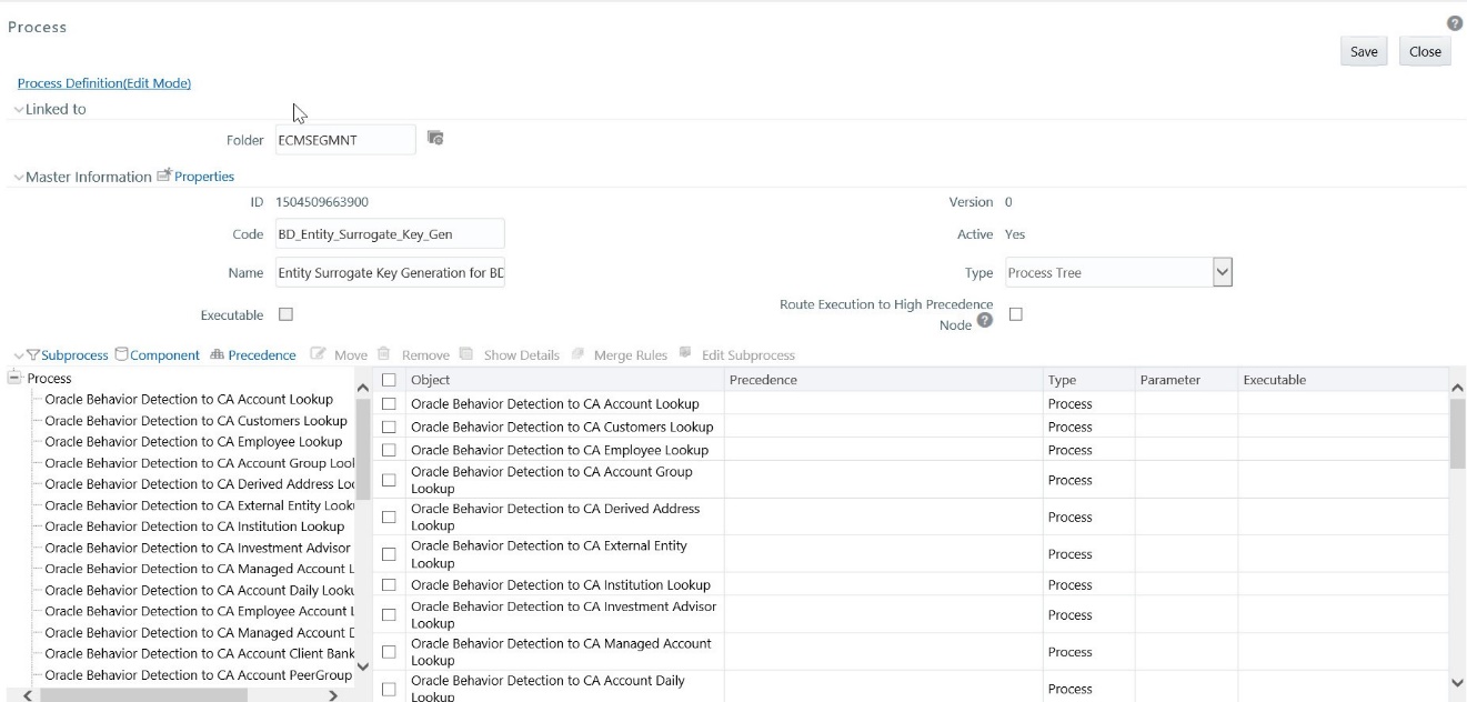

- Navigate to the Process Summary window and searchBD_Entity_Surrogate_Key_Gen.
- The list of tasks is displayed. ClickComponent.
Figure 9-8 List of Tasks

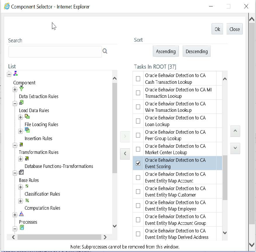

- Select Oracle Behavior Detection to CA Event Scoring and click
OK.
Figure 9-9 Deselecting of Oracle Behavior Detection to CA Event Scoring Process
