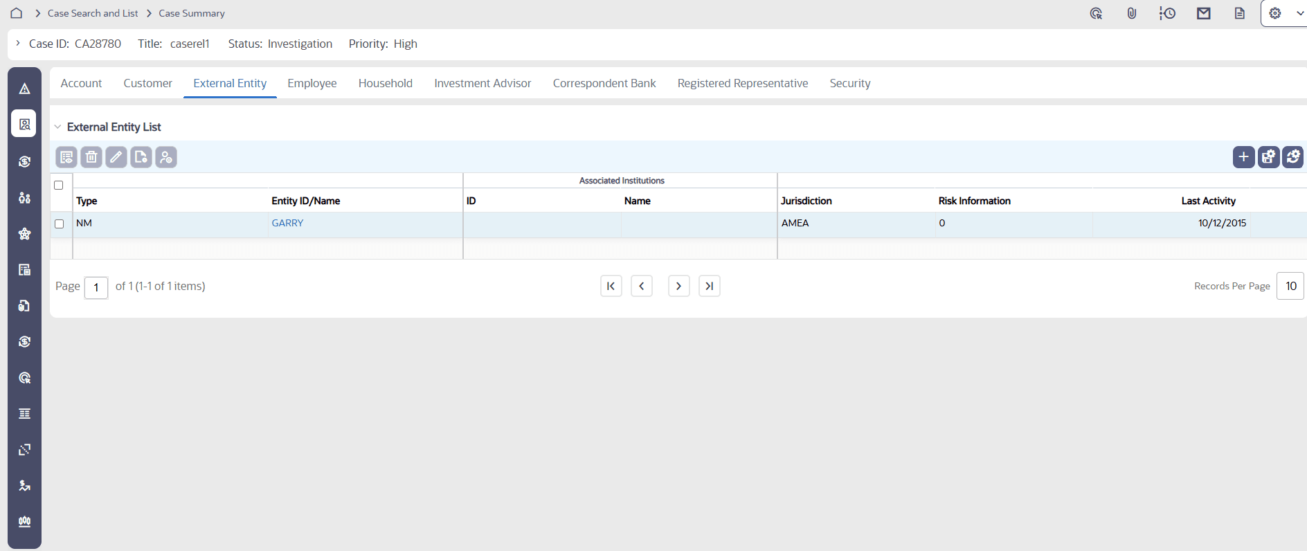

The External Entity tab allows performing detailed analysis of external entities associated with the case to determine case resolution. The External Entity tab has the following sections:
  • External Entity List: details the list of external entities associated with the selected case. The following details are displayed:
    • Type: Displays the type of entity. For example, XA for external account.
    • Entity ID/Name: Displays the name or ID of the external entity.
    • Associated Institution: Associated institutions may be banks, financial institutions, and so on. The Associated Institution column displays a summary of the associated institutions related to the selected external entity. This section displays details such as bank name and bank ID details. This has two subsections: ID and Name
    • Jurisdiction: Displays the name of the jurisdiction.
    • Risk Information: Displays the value of risk associated with the selected external entity.
    • Created On: The date when the record was created in the business data.
    • Last Activity: The last activity date of this external entity.
    • Last Updated: The date when the record was updated during an edit.
    • Edit History: Click the History link to view a historical record of changes made to the external entity records. This link displays only for records which have been edited.

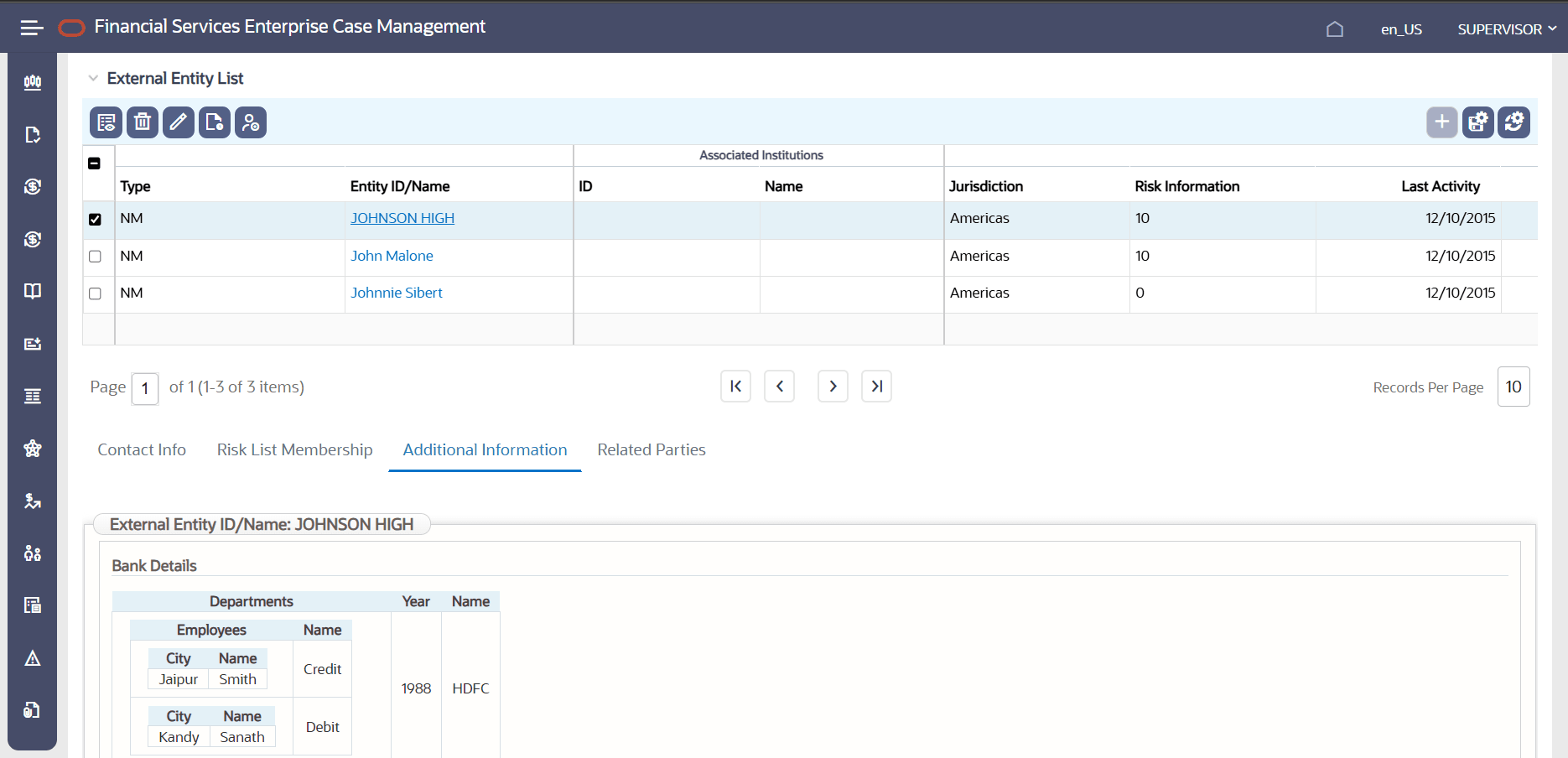

Viewing Additional Information
This section displays additional information about the external entity provided in the Add External Entity API. Multiple levels of information is displayed in simplified manner. You cannot modify the information displayed on this tab.
Figure 5-41 Additional Information
