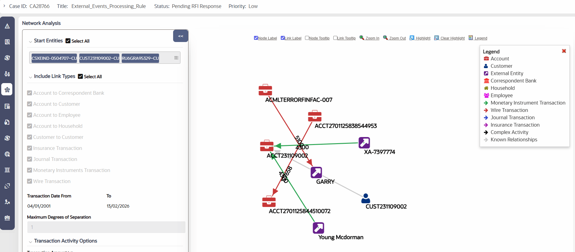

5.6.1.9.6 Using Graph Toolbar
The Graph Toolbar allows you to perform general operations associated with the graph. It displays on the top of the Network Graph page. You can select different toolbar options such as Node Label, Link Label, and so on.

    Figure 5-25 Graph Toolbar
    Graph Toolbar
