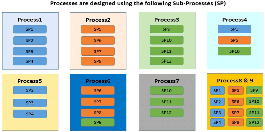

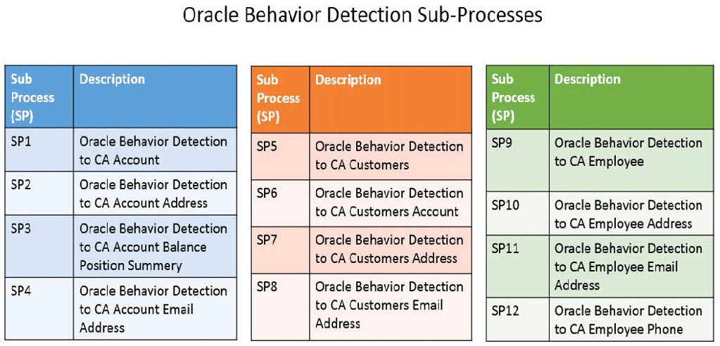

Sample Processes
These sample processes are designed using OOB Oracle Behavior Detection Business data processes (Oracle Behavior Detection to CA Account Address, Oracle Behavior Detection to CA Customer, Oracle Behavior Detection to CA Employee Email Address, and so on).
The sub-processes used to create a process, from process1 to Process9 are part of OOB Business Data Movement processes. In the out of box batch run, these sub-processes can be run in both parallel and sequence.
You can create processes based on your requirements. The processes are created using sub-processes considering various parameters such as scenario, focus, and associated business data, the volume of records, hardware configuration, and so on.
Table 7-5 Sample Processes

Process1
This process is designed using the following sub-processes (OBD to CA Account):
  • l Oracle Behavior Detection to CA Account,
  • l Oracle Behavior Detection to CA Account Address,
  • l Oracle Behavior Detection to CA Account Balance Position Summary,
  • Oracle Behavior Detection to CA Email Address, and so on.
Process2
This process is designed using the following sub-processes (OBD to CA Customer):
  • Oracle Behavior Detection to CA Customers,
  • Oracle Behavior Detection to CA Customers Account,
  • Oracle Behavior Detection to CA Customers Address,
  • Oracle Behavior Detection to CA Customers Email Address,
  • Oracle Behavior Detection to CA Customers IMP License, and so on.
Process3
This process is designed using the following sub-processes (OBD to CA Employee):
  • Oracle Behavior Detection to CA Employee,
  • Oracle Behavior Detection to CA Employee Address,
  • Oracle Behavior Detection to CA Employee Email Address,
  • Oracle Behavior Detection to CA Employee Phone,
  • Oracle Behavior Detection to CA Employee to Account, and so on
Process4
This process is designed using the following sub-processes:
  • Oracle Behavior Detection to CA Account,
  • Oracle Behavior Detection to CA Customers, and so on.
Process5
  • Oracle Behavior Detection to CA Account Address
  • Oracle Behavior Detection to CA Account Balance Position Summary
  • Oracle Behavior Detection to CA Account Email Address, and so on.
Process6
Process7
  • Oracle Behavior Detection to CA Employee to Account, and so on.
Process8 & 9 These processes are designed using all sub-processes.
  • The above process names are used for reference purposes.
  • Process 1, 2, and 3 are designed based on a similar entity bucketed into one process.
  • Process4, 5, 6, and 7 are designed based on the distribution of the volume of data. For example, if Process4 has a huge volume of data compare to Process5, 6, and 7. You can design the process (business data movement) in such a way that the Process4 runs in parallel with Pro- cess5, internally, Process5, 6, and 7 can run in sequence.

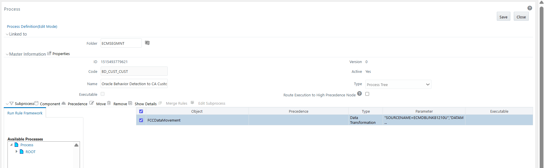

To modify the existing process for a full load, follow these steps:
  1. Navigate to Enterprise Case Management Application.
  2. Go to the Common Task section and select the Run Rule Framework.
  3. Click Process. The Process Summary window is displayed with the available Processes.

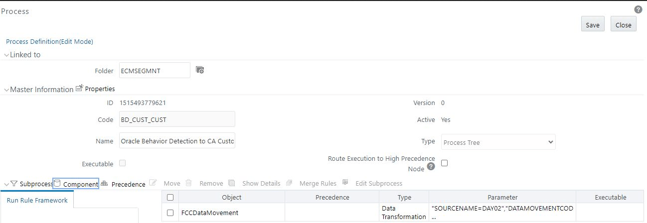

  4. Search for BD_CUST_CUST and click Edit.
    Figure 7-5 Searching a Process
    This image shows the Searching Process screen.
  5. Click Component.
    Figure 7-6 Process Component
    This image shows the Process Component.

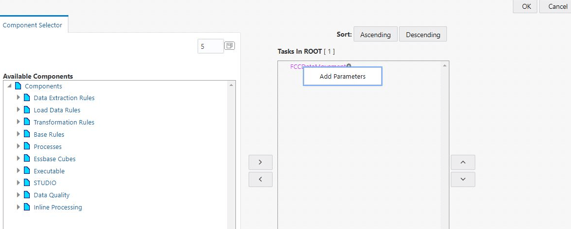

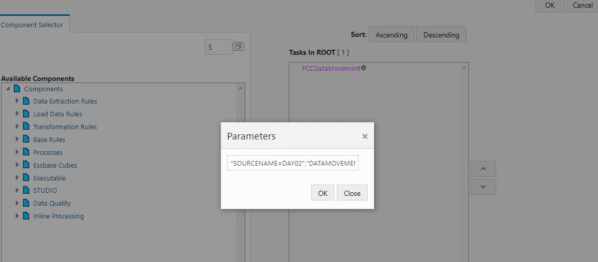

  6. Right-click on FCCData Movement and then click Add Parameters.
    Figure 7-7 FCCData Movement and Add Parameters
    This image shows the FCC Data Movement and Add Parameters screen.
  7. Replace the existing parameter value with: "SOURCENAME=DAY02","DATAMOVEMENTCODE=BD_CUST_CUST","LOADTYPE=DBLINK","DATAMOVEMENTOPERATION=DDI".
    Figure 7-8 Replace Existing Parameters
    This image shows the Replace Existing Parameters screen.
  8. Click OK.
  9. Click Save and then click No when prompted to save a new version.
    • The FCC_CUST_CUST table is fully refreshed from the CUST_CUST table during batch execution

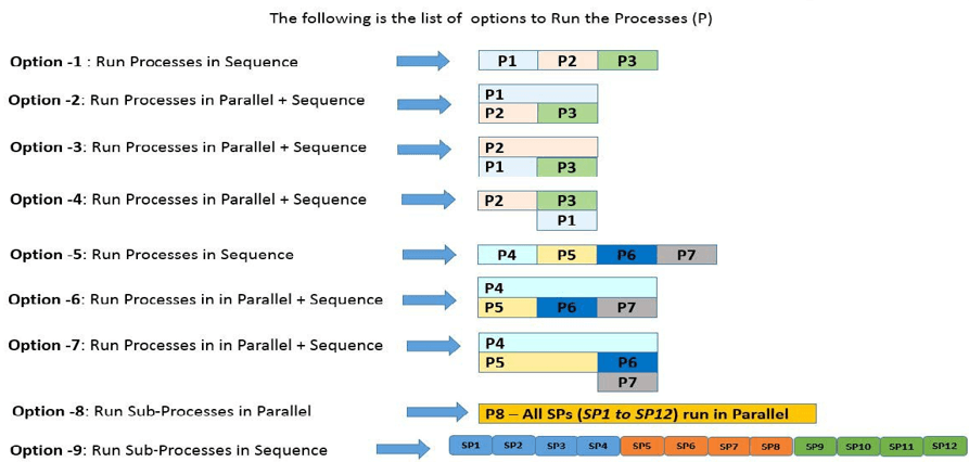

You can run Processes using the list of options shown in the following figure.
Figure 7-11 Options- processes
This image shows the Options- processes.
Table 7-6 Options
Option Description
1
P1, P2, and P3 processes are configured in sequence.
  • l In P1, sub-processes - SP1, SP2, SP3, and SP4 will run in parallel.
  • Once the P1 is completed, P2 will start and sub-processes SP5, SP6, SP7, and SP8 will run in parallel.
Once P2 is completed, P3 will start and sub-processes SP9, SP10, SP11, and SP12 will run in parallel.
2
P1 and P2 will start in parallel and P3 will start only after P2 is completed, irrespective of P1 is completed or not.
  • InP1, sub-processes - SP1, SP2, SP3, and SP4; in P2, sub-processes- SP5, SP6, SP7, and SP8 will run in parallel.
Once the P2 is completed, P3 will start and sub-processes SP9, SP10, SP11, and SP12 will run in parallel.
3
P2 and P1 will start in parallel and P3 will start only after P1 is completed, irrespective of P2 is completed or not.
  • InP2, sub-processes - SP5, SP6, SP7, and SP8; in P1, sub-processes- SP1, SP2, SP3, and SP4 will run in parallel.
Once the P1 is completed, P3 will start and sub-processes SP9, SP10, SP11, and SP12 will run in parallel.
4
Only after completion of P2, P3 and P1 will start in parallel.
  • l In P2, sub-processes - SP5, SP6, SP7, and SP8 run in parallel.
P3- SP9, SP10, SP11, and SP12, and P1 - SP1, SP2, SP3, and SP4 sub-process will run in parallel only after completion of all sub-processes of P2.
5
P4, P5, P6, and P7 processes are configured in sequence. P4 - SP1, SP5, and SP10 will run in parallel.
  • l Once the P4 is completed, P5- SP2, SP3, and SP4 will start in parallel.
  • l Once the P5 is completed, P6- SP6, SP7, SP8, PS9 will start in parallel.
Once the P6 is completed, P7- SP10, SP11, and SP12 will start in parallel.
6
P4 and P5 will start in parallel and P6 will start only after P5 is completed, and followed by P7 irrespective of P4 is completed or not.
  • InP4, sub-processes – SP1, SP5, and SP10; in P5, sub-processes- SP2, SP3, and SP4 will run in parallel.
  • Once the P5 is completed, P6 will start and sub-processes SP6, SP7, SP8, and SP9 will run in parallel.
Once the P6 is completed, P7 will start and sub-processes SP10, SP11, and SP12 will run in parallel.
7
P4 and P5 will start in parallel. P6 and P7 will start in parallel only after P5 is completed, irrespective of P4 is completed or not.
  • In P4, sub-processes - SP1, SP5, and SP10; in P5, sub-processes- SP2, SP3, and SP4 will run in parallel.
P6- SP6, SP7, SP8, and SP9, and P7 - SP10, SP11, and SP12 sub-process will run in parallel only after completion of all sub-processes of P5.
8 Once P8 starts, all sub-processes from SP1 to SP12 will run in parallel.
9 All sub-processes will run in sequence from SP1 to SP12.
  • The same sub-processes should not be part of two processes. For example, you should add P1 and P4 in the same run as they have similar sub-process (SP1).
  • The above options are used as samples, you can configure your own options based on the requirement.

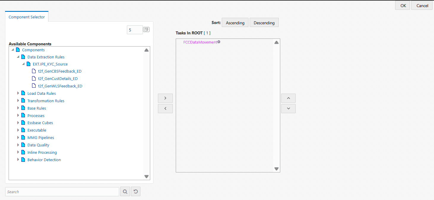

Adding Transformation Rule
To add a Transformation Rule, follow these steps:
  2. Go to the Common task section. Select the Run Rule Framework.
  3. Click Run. The Run window is displayed.
  4. Go to the List section. Select an application for example (Oracle_BD_Event_Processing) and click Edit. The list of processes for the selected application is displayed.
  5. Select Job from Selector.
    Figure 7-12 Add Transformation Rule
    This image describes how to add a Transformation Rule.
  6. Click Components and select required Transformation Rule, move to Tasks list using Click Ok. Transformation Rule will be added to process.
    Figure 7-13 Transformation Rule Added
    This image shows that the Transformation Rule is added.
