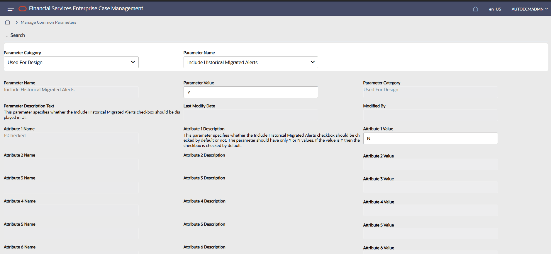

To modify the Include Historical Migrated Alerts parameter, follow these steps:
  1. Open the Manage Common Parameters window.
  2. Select Used for Design from the Parameter Category drop-down list.
    Figure 14-8 Include Historical Migrated Alerts
    This image shows the Include Historical Migrated Alerts screen
  3. Select Include Historical Migrated Alerts from the Parameter Name drop-down list.
  4. Edit the required parameter details and click Save. A confirmation dialog box appears with the message: Would you like to Save these actions?
  5. Click OK. A dialog box appears with the message: Update Operation Successful.
  6. Click OK. The Manage Common Parameters page is displayed.
