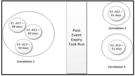

  1. In the below example, Event E1, E2, and E3 are correlated in Correlation 1. When the task for Event expiry is executed, Event E1 will be out of the case correlation based on the defined IPE rule. Event E2 and Event E3 will be correlated to Correlation 2 and Correlation 3 respectively.
    Figure 20-27 Event E1, E2, and E3 are correlated in Correlation 1
    This image shows that the 1st example of the Event E1, E2, and E3 are correlated in Correlation 1.

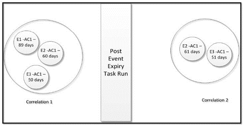

  2. In the below example, Event E1, E2, and E3 are correlated in Correlation 1. When the task for Event expiry is executed, Event E2 will not be promoted to the case based on the defined IPE rule. Event E1 and Event E3 will be correlated together in Correlation 2.
    Figure 20-28 2nd example of Event E1, E2, and E3 are correlated in Correlation 1
    This image shows that the 2nd example of the Event E1, E2, and E3 are correlated in Correlation 1.

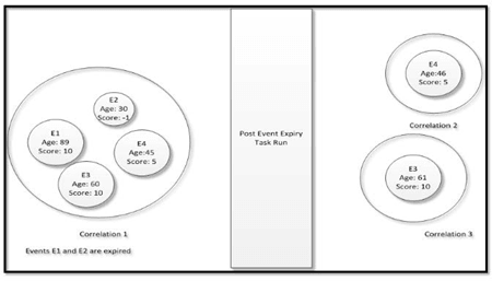

  3. In the below example, Event E1, E2, E3, and E4 are correlated in Correlation 1. When the task for Event expiry is executed, Event E1 and Event E2 will not be promoted to case based on defined scoring. Event E3 and Event E4 will be correlated to Correlation 2 and Correlation 3 respectively.
    Figure 20-29 3rd example of Event E1, E2, and E3 are correlated in Correlation 1
    This image shows that the 3rd example of the Event E1, E2, and E3 are correlated in Correlation 1.

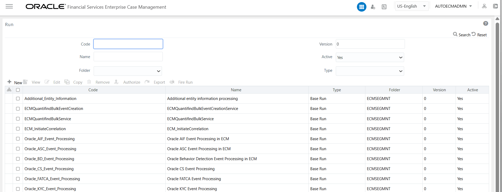

  3. Go to the Common task section. Select the Run Rule Framework.

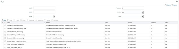

  4. Click Run. The Run Summary window is displayed with the available Processes.
    Figure 20-30 Run Summary screen
    This image shows the Run Summary screen.

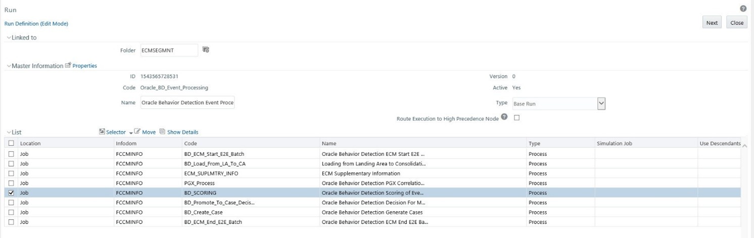

  5. Go to the List section. Select Oracle_BD_Event_Processing. The list of processes for OBD is displayed. Select the BD_Scoring code and Job option from Selector.
    Figure 20-31 Run Summary Details screen
    This image shows the Run Summary Details screen.

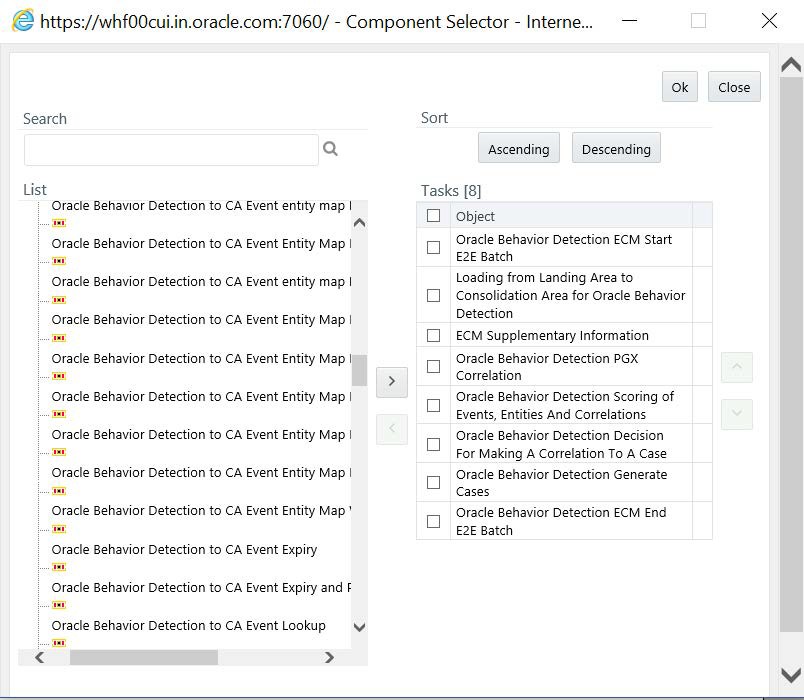

  6. The Component Selector window is displayed. Select Oracle Behavior Detection to CA Event Expiry and Prege process from the list and move it to Task list.
    This process has the following two sub-processes:
    • Oracle Behavior Detection to CA Event Expiry
    • Oracle Behavior Detection to CA Orphaned Event Purge
    Figure 20-32 Component Selector
    This image shows the Component Selector.

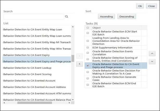

  7. Select the precedence of Oracle Behavior Detection to CA Event Expiry and Prege process after the Oracle Behavior Detection Scoring of Events, Entities And Correlations. Click Ok.
    Figure 20-33 OBD to CA Event Expiry and Prege Process Components
