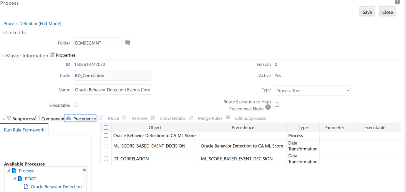

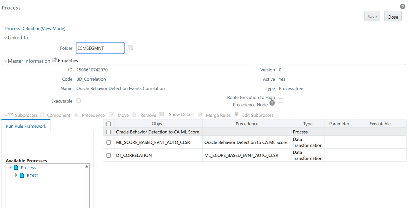

    2. Add below processes or Data Transformation Tasks inside BD_Correlation in below order.
      1. BD_ML_Score - Oracle Behavior Detection to CA ML Score- This is to fetch the ML Score from Studio and populate in FCC_EVENTS table.
      2. Either ML_SCORE_BASED_EVNT_AUTO_CLSR or ML_SCORE_BASED_EVENT_DECISION based on client requirement:
        • If client needs to autoclose and update decision of Events based on the Threshold configured (outlined below) then Add ML_SCORE_BASED_EVNT_AUTO_CLSR Data Transformation Task.
        • If client needs to just update decision of Events based on the Threshold configured (outlined below) and allow them to participate in Correlation then Add ML_SCORE_BASED_EVENT_DECISION Data Transformation Task.
          Figure 19-1 Autoclosure and Autodecisioning of Events
          Figure 19-2 Only Autodecisioning of events
