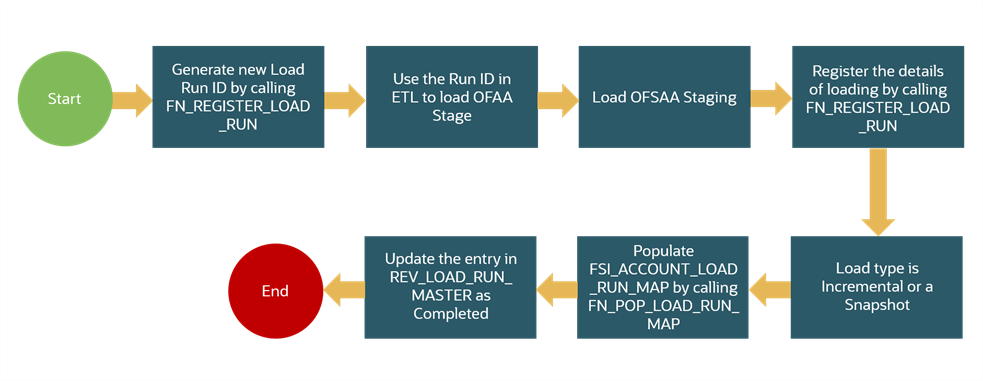

Before loading data into the staging table, generate a Load Run Identifier to stamp the records from the source. These records can be a complete snapshot or can be partial or incremental data too. This load run identifier can be generated by calling the function in the OFSAA atomic schema named fn_register_load_run. The function expects some input parameters and returns a unique load run identifier back to the calling program.
Figure 15-1 Generate the Load Run Identifier
This illustration shows generating the Load Run Identifier. The explanation precedes this illustration.
