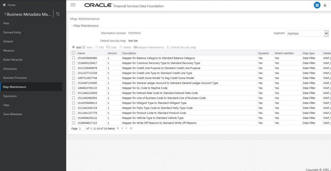

  1. Navigate to OFSAAI, select Financial Services data Foundation, select Unified Analytical Metadata, select Business Metedata Management, select Map Maintenance. The Map Maintenance page is displayed.
    Figure 29-1 Navigate to the Map Maintenance page
    This illustration shows the navigation to the Map Maintenance page.

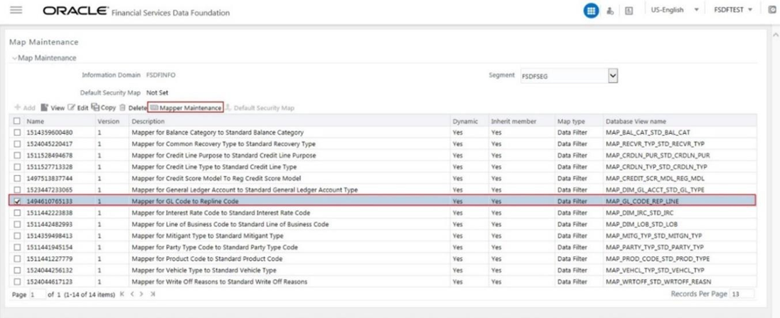

  2. Select the mapper record Mapper for GL Code to Repline Code and then click the Mapper Maintenance icon.
    Figure 29-2 Select the Mapper in the Map Maintenance page
    This illustration shows the selection of the Mapper in the Map Maintenance page. Select the Mapper for the GL code to Repline code and click the Mapper Maintenance icon to open the Mapper Maintenance page for the selected Mapper.

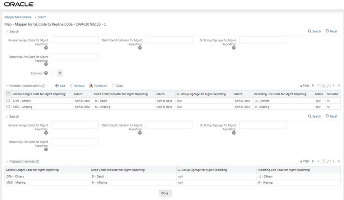

  3. The Mapper Maintenance page is displayed. The GL codes OTH and MSG are out-of-the-box mappings. You can maintain the remaining mappings according to the user specific values.
    Figure 29-3 Mapper Maintenance page
    This illustration shows the Mapper Maintenance page with the Mapper for GL code to Repline code. Data Foundation application maps OTH and MSG out-of-the-box for this mapper. You can maintain the remaining mappings according to the requirement.
