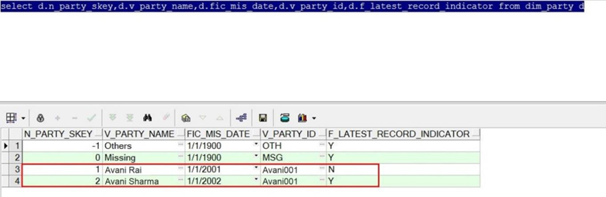

- Add the required data records to their Master table and for the required
FIC_MIS_DATE. For example, added two records to STG_PARTY_MASTER. The resultant
image is shown below.
Figure 37-1 Sample of adding records for the backdated Run execution using LRI
Ensure that V_PARTY_ID is same in this step and the LRI batch execution step. - Execute the SCD batch to add the required records from Master table to its Dimension
table with the required FIC_MIS_DATEs. For example, execute SCD batch to add records
from STG_PARTY_MASTER to DIM_PARTY. The resultant data record in the DIM_PARTY is as
shown below:
Figure 37-2 Sample after executing the SCD batch for first record for the backdated Run execution using LRI
- After adding the first record to DIM_PARTY for the FIC_MIS_DATE 1/1/2001, the flag F_LATEST_RECORD_INDICATOR associated with this data record is set to Y.
- After adding the second record to DIM_PARTY for the FIC_MIS_DATE 1/1/2002, the flag F_LATEST_RECORD_INDICATOR associated with this data record is set to Y, and the flag
Figure 37-3 Sample after executing the SCD batch for the second record for the backdated Run execution

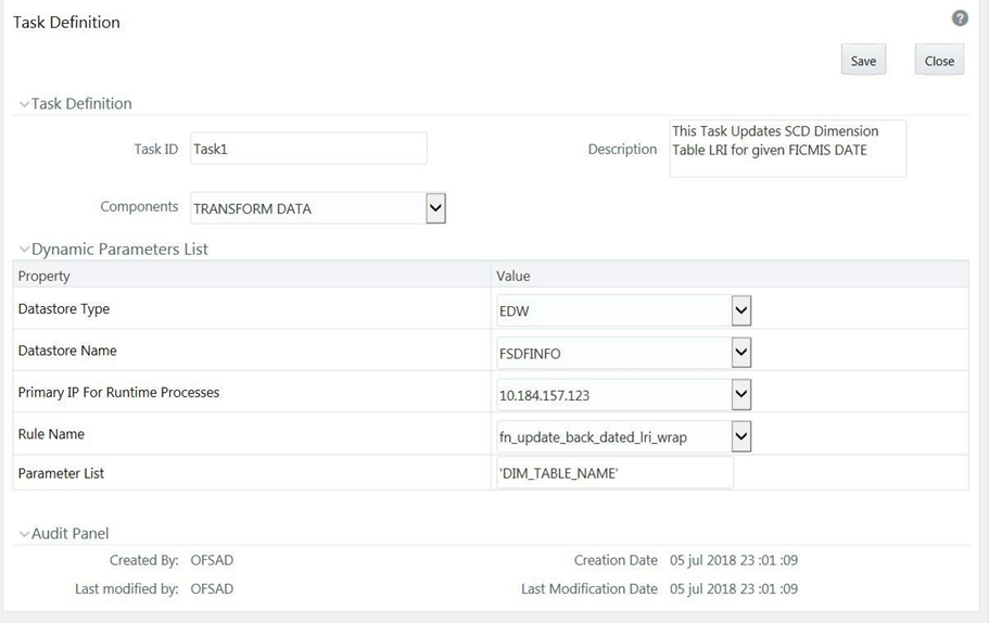

- In Batch Maintenance, add a Task for the LRI Dimension table. In the
Parameter List field, mention the Dimension table name (‘DIM_TABLE_NAME’)
for which Backdated Run using LRI must be executed. In this example,
‘DIM_TABLE_NAME’ = ‘DIM_PARTY’.
Figure 37-4 Add Task for the LRI table

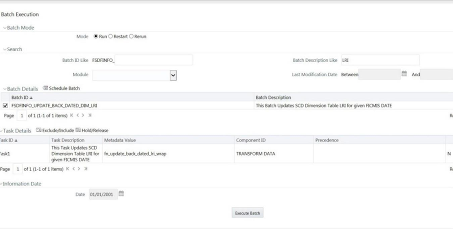

- In the Batch Execution window, execute the UPDATE_BACK_DATED_DIM_LRI batch for
different FIC_MIS_DATEs.
Figure 37-5 Execute the LRI batch
