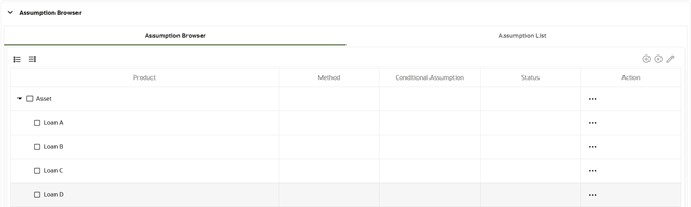

  1. Navigate to the Add-On rate Assumption Browser Page.
    Figure 2-6 Add-on Rate Rule Assumption Browser
