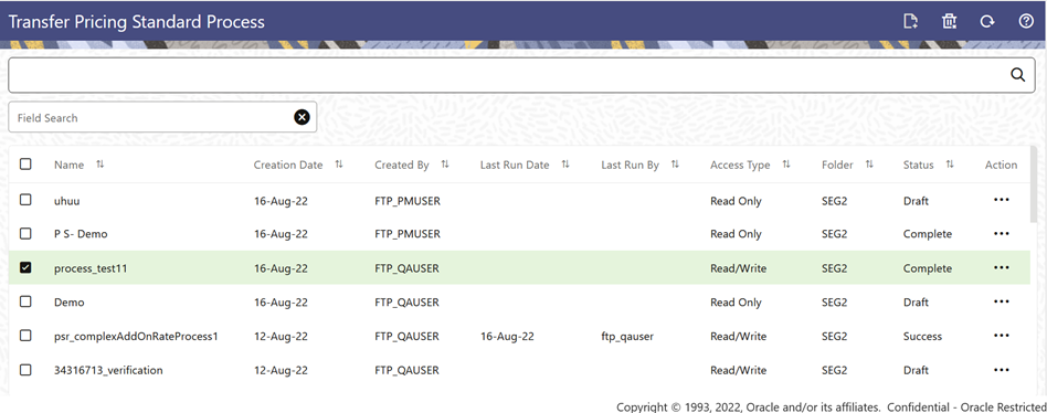

Transfer Pricing Standard Processes are executed from the Transfer Pricing Standard Process Summary Screen. To open the Transfer Pricing Standard Process Summary Screen, from the LHS Menu, select Operations And Processes, and then select Standard Process.
Figure 2-1 Transfer Pricing Standard Process Summary Page
