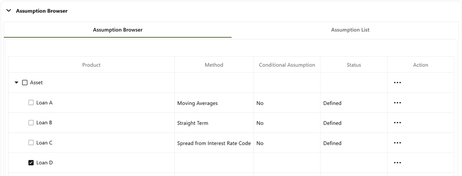

The Conditional Assumption UI is accessed from the Assumption Browser by selecting the Conditional Assumption icon.
Figure 2-21 Assumption Browser
Assumption Browser

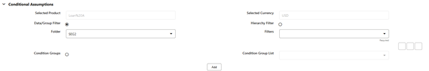

The Conditional Assumption screen allows users to select explicit conditions (from Data Filters and/or Hierarchy Filters), apply methods, and rule selections to each condition directly. The Filter Conditions are processed by the engine in the order that they appear on the screen. After a condition is satisfied, the related assumption is applied. The following figure displays a representative Conditional Assumption using a Data Filter:
Figure 2-22 Conditional Assumptions
If an instrument record does not meet any of the conditions, then the rule logic reverts to the standard assumption that is directly assigned to the Product / Currency combination.
