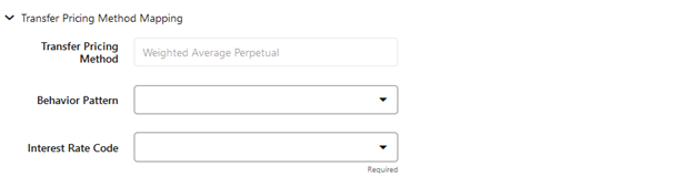

Figure 2-17 Weighted Average Perpetual

- Behavior Pattern: Select the Behavior Pattern that is associated with the Product/Currency combination being defined.
- Interest Rate Code: Select the Interest Rate Code, which you want to use as the Transfer Pricing Yield Curve.
The Weighted Average Perpetual method applies to both Instrument Balances and Ledger Balances.
