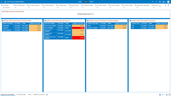

This canvas allows you to look at the Number of Accounts outliers that are calculated using the Standard Deviation capability available off the shelf with Oracle Analytics.
The Number of Accounts pertaining to the Instrument level data is segregated between “Outlier” and “Non-Outlier” in the report column “Outlier”.
“Outlier” in this case refers to the Number of Accounts, for a particular subset related to a combination of Dimensional Values that lie outside the confidence interval of the deviation that we are adopting in our technique.
“Non-Outlier” would refer to the Number of Accounts, for a particular subset related to a combination of Dimensional Values that lie inside the confidence interval of the deviation.
The Outliers are calculated on the Number of Accounts aggregated by the respective combination of Dimensional Values, such as Industry, Org Unit, Customer Segment, and Currency against the As-of-Date available.
Figure 6-12 “Number Accounts Outliers” Report Canvas
The Number of Accounts can be identified as an Outlier or a Non-Outlier based on the standard deviation confidence interval that we adopt.
This confidence interval is parametrized with the list of the Sigma values available in the report that is “Attributes.Sigma Factor 1”, “Attributes.Sigma Factor 2” and “Attributes.Sigma Factor 3”.
The Sigma Factors are integer values that range from “Attributes.Sigma Factor 1” to “Attributes.Sigma Factor 3” in the increasing order of the conservativeness or the confidence interval of the Standard Deviation.
This means will have more Outliers when you perform analysis with “Attributes.Sigma Factor 1” than with the “Attributes.Sigma Factor 3”.
The following screenshot shows the selection for the Sigma Factor available in the report canvas.
Figure 6-13 Sigma Factor selection for STD Deviation
You can use a series of Report Prompts, as previously described, to filter the data according to key attributes pertaining to the underlying Instrument level data.
The report displays the underlying Instrument account data according to the following Charts’ logic:
- Select Sigma Value for STD Deviation: The chart provides you with a selection capability for the desired Sigma value to be used by the STD Deviation, the possible selection values are “Attributes.Sigma Factor 1”, “Attributes.Sigma Factor 2”, and “Attributes.Sigma Factor 3”.
- Number of Accounts trends by Industry Sector: This chart
deduces if the Number of Accounts related to the different Industry Sectors is an
“Outlier” or “Non-Outlier” for a combination of As-of-Date and Industry Leaf
Name.
The columns displayed in the chart are as follows:
- Industry Leaf Name
- As Of Date
- Outlier
- Number of Accounts trends by Org Unit: This chart deduces if
the Number of Accounts related to the different Org Units is an “Outlier” or
“Non-Outlier” for a combination of As-of-Date and Org Unit Leaf Name.
- Org unit Leaf Name
- As Of Date
- Outlier
- Number of Accounts trends by Customer Segment: This chart
deduces if the Number of Accounts related to the different Customer Segments is an
“Outlier” or “Non-Outlier” for a combination of As-of-Date and Customer Type
Name.
- Customer Type Name
- As Of Date
- Outlier
- Number of Accounts trends by Currency: This chart deduces if
the Number of Accounts related to the different Currencies is an “Outlier” or
“Non-Outlier” for a combination of As-of-Date and Currency Code.
- Currency Code
- As Of Date
- Outlier
