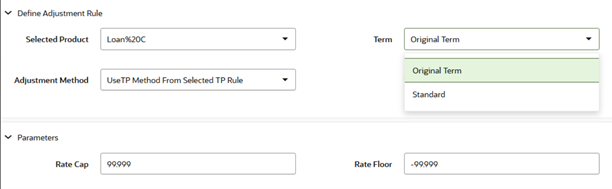

Figure 5-74 Add-On rate Method – Use TP Method (Term Selection)
