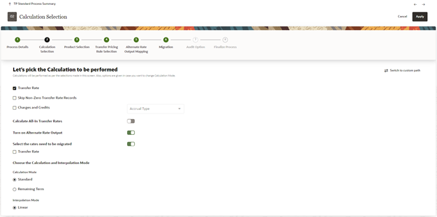

The Calculation Selection Screen displays various calculation options that you can select. Depending on the choices you make, the progress train on the Screen include few optional steps like Audit, Migration, and Prepayment Rule selection. In the below sample Screen, the options Turn On Alternate Rate Output and Select the rates need to be migrated are selected; accordingly progress train on the top, starts displaying the Alternate Rate Output Mapping and Migration options as well.
You can switch the UI to a Custom Calculation Selection at any time. Clicking Switch to custom path will help you if you realize given calculation options in selected scenario, does not have all the required calculation and you like to customize the selection. When you enable the custom flow, a confirmation message is displayed to confirm the re-routing to custom flow.
Figure 5-99 Calculation Selection
