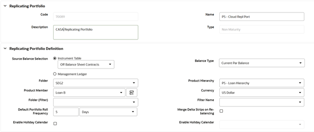

- From the LHS Menu, select Maintenance, and then select Replicating Portfolio.
- Click the Add
icon.
Figure 5-31 Replicating Portfolio Details Page
- Add the following details:
This table describes various fields in the Replicating Portfolio Details Page. You can enter or select the relevant details to populate the screen to define Replicating Portfolio for the Tractor TP Method use.
Table 5-18 Key Terms used in the Replicating Portfolio Details Page
Term Description Code Enter a unique code for the Replicating Portfolio. Name Enter a unique name for the Replicating Portfolio. Description Enter description for the Replicating Portfolio. Type For Replicating Portfolio, the type is defaulted to the core. The Volatile Strip is generated automatically as a Reconciling Plug Entry to Balance the Portfolio. The term of the Plug Entry is defaulted to 1 Day unless a Holiday Calendar is used, in which case the Volatile Amount Maturity can be extended to the next business day. Source Balance Selection The Source Balance selection allows you to use the source as Instrument Table, Aggregate Table (or Ledger Table). Balance Type The Balance Type allows you to select the type of balance. It can be either Average Balance or Ending Balance if the source is Management Ledger. In addition, the Cur Par, Cur Book or Average Book Balance if the source is one of the Instrument Tables. Folder Select the folder from where you want to pick the Product Hierarchy. Product Hierarchy Pick one Product Hierarchy from the selected folder. Product Member Select Products for which Replicating Portfolio is being defined. Currency Pick one Currency from active List of Currencies. Folder (Filter) If any filters are required to define the Portfolio, select the Folder where Filter is stored. Filter Name Pick one Filter to enhance the granularity of Replicating Portfolio. Default Portfolio Roll Frequency The Default Portfolio Roll Frequency Option allows you to set the default Rolling Frequency of the Replicating Portfolio. Merge Data Strips on Re-balancing If Merge Delta Strips on the Re-balancing option are enabled, then the Core Strips will be merged during the rebalancing. Enable Holiday Calendar Replicating Portfolio's allow users to enable a Holiday Calendar. If this option is selected, Portfolio Strips will not be generated on weekends or holidays. In addition, during rollover of Maturing Strips, new Maturity Dates will be adjusted to ensure maturities fall only on working days. Holiday Calendar Code The Holiday Calendar code allows users to select the applicable holiday calendar. Holiday Calendar Rolling Convention The Rolling Convention within Replicating Portfolios is defaulted to the next Business Day. Related to this method is an Additional Date Adjustment to ensure that only one core strip falls on a single date. The Funds Transfer Pricing Could Service refers to this secondary adjustment as an exclusive business day convention. Generate the Portfolio After initially creating (and saving) the Replicating Portfolio Definition, users should generate the Portfolio. This action launches a background process that generates the Strip Records for the Portfolio. Before running this process, be mindful of the As-of-Date defined in your Application Preferences, as this date will be used as the initial Origination Date for the newly created Strips.

View the Portfolio This option allows you to view the Portfolio Strips. - Make your required selections in the Source Balance Selection section.
- Select the Balance Type based on the Source selected.
- Click Add Core (one or more) to input the core amount, associated maturity term, and strip frequency.
- To delete a row, select the check box corresponding to the row you want to remove and click the Delete icon.
- Click Save.

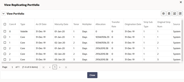

- You can view the Portfolio using View action in Portfolio Configuration. There
are other actions buttons to roll the Portfolio forward/backward and rebalance
as per Changing Balance on each subsequent As-of-Date.
Figure 5-34 View Portfolio
- In View Portfolio Screen, you can modify Strip Balance, add or delete existing
Strips. Options are given to export and import the whole Portfolio to an Excel
Sheet.
