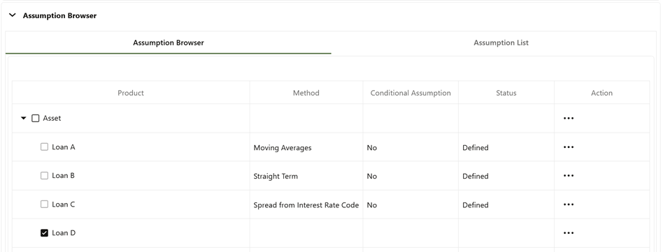

Oracle Funds Transfer Pricing Cloud Service extends the setup and maintenance of assumptions by allowing users to integrate conditional logic (optional) into the setup of Transfer Pricing, Prepayment, and Transfer Pricing Adjustment methods. The Caterpillar Method under Transfer Pricing Rules will not be available for selection under Conditional Assumptions.
The Conditional Assumption UI is accessed from the Assumption Browser by selecting the Conditional Assumption icon.
Figure 5-57 Assumption Browser
Assumption Browser
