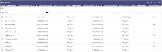

Figure 5-126 Rate Reports
The Rate Report Summary page displays all the existing Rate Reports.

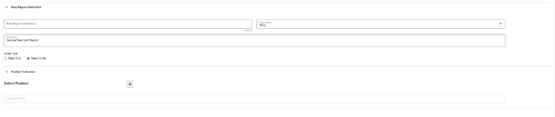

To define a Rate Report:
  1. Enter the Rate Report Name and Description.
  2. Select the Folder Name and Access Type details.
    Figure 5-128 Rate Report – Definition Mode
    This screen allows you to create a new Rate Report.

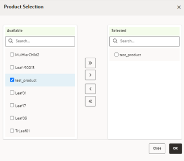

  3. Select the Product(s) from the hierarchy browser using the Add icon. This hierarchy browser will have the list of defined standard products (as set up by the Administrator).
    Figure 5-129 Product Selection – Hierarchy Browser
    This Hierarchy Browser allows you to select the product for the Rate Report.
  4. Click Save.

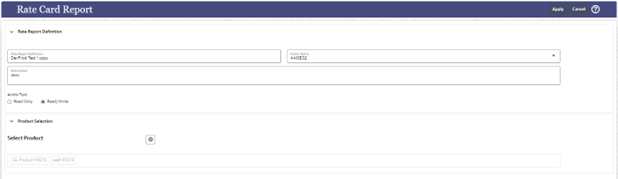

To access a Rate Card Report, select the Rate Report Name and click Report from the Action menu.
Figure 5-130 Rate Report
Rate Report displays the Rate Report Definition.
