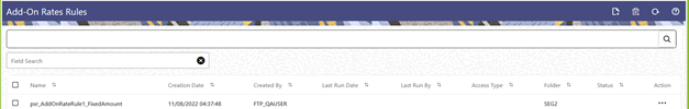

5.3.4.1.1 Search Pane
There are two Search options provided to search the Add-on Rate Rules on the Summary Page.
To search the Add-on Rate Rules:
  1. Click the Search icon on the Search pane to collapse (display) the Criteria window.
    Figure 5-63 Search Window
    Search Window
  2. Enter the Add-on Rate Rule Name or Description and click Search to display the Rule that match the criteria.
  3. Click Cancel to remove the filter criteria on the Search window and refresh the Window.
  4. Click Search after entering the search criteria. The search results are displayed in a table containing all the Add-on Rate Rules that meet the search criteria.
  5. The other method to search an Add-on Rate Rule is using the Field Search option. The Field Search is an inline wildcard UI search that allows you to enter value partially or fully and the rows that match the entered string in any of its column is fetched in the Summary table.
