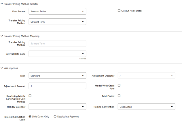

Figure 5-47 Straight Term
Straight Term

The following options become available in the application with this method:
  • Term: Select from Standard, Original Term, or Reprice Frequency. Standard is the default selection and the resulting Term will follow the above logic. The Original Term and Reprice Frequency options allow users to override the standard logic and specify which term to use.
  • Adjustment Operator: When either Original Term or Reprice Frequency is selected as the Term, the Adjustment Operator becomes active. The term Adjustment is optional and gives users the ability to modify the term
  • Adjustment Amount: This input works together with the Adjustment Operator to indicate how the term should be modified.
  • Interest Rate Code: Select the Interest Rate Code to be used for Transfer Pricing the account.
  • Mid-Period Repricing Option: Select the check box beside this option to invoke the Mid-Period Repricing option.
  • Holiday Calendar: Select whether a Holiday Calendar is applicable for calculating the charges/credits or for calculating Economic Value.
  • Rolling Convention: Select the appropriate Business Day Rolling Convention if a Holiday Calendar is selected.
  • Interest Calculation Logic: Select the appropriate option to indicate how the interest payment should be adjusted when a Holiday Date is encountered.
