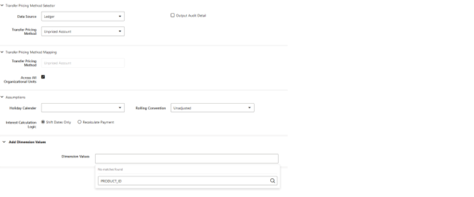

Under the Unpriced Account Method, the transfer rate for the account is defined as the Weighted Average of the Product Dimension Members. While using the unpriced account methodology, you can specify whether the Weighted Average of transfer rates has to be taken across all organizational units or for accounts only within that organizational unit.
Figure 5-54 Unpriced Account
Unpriced Account
The following options become available in the application with this method:
  • Add Dimension Values: This allows you to select the Product Dimension Members whose Weighted Average Transfer Rate will be assigned to the product being defined.
You should not base an unpriced account on another unpriced account.
  • Across all Organization Units: This allows you to specify whether the Weighted Average of transfer rates should be taken across all organizational units. If this option is not selected, the Weighted Average Rate will be calculated for each Org Unit. To calculate for each individual Org Unit, you must also select the Org Unit Dimension under Migration Dimensions in the Transfer Pricing Process.
