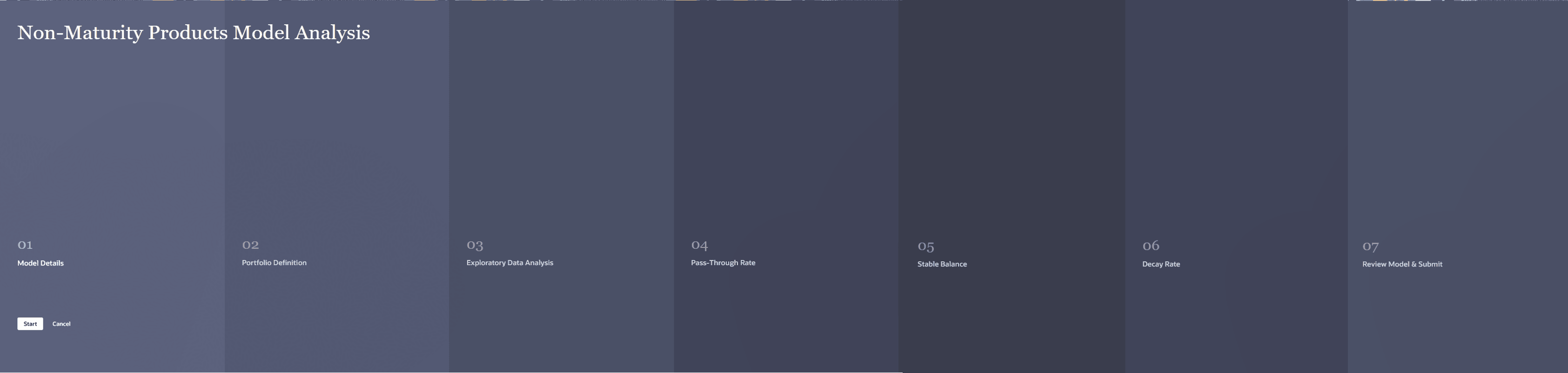

6.4.2.2.1 Creating Non-Maturity Products Model
To create a new Non-Maturity Products Model Analysis Rule, perform the following steps:
- Navigate to the Non-Maturity Products Model Analysis page.
- Click Add. The Create Non-Maturity
Products Model Analysis page is displayed.
Figure 6-206 Create Non-Maturity Products Model Analysis
- Follow the steps mentioned in below sections:
- Model Details
- Portfolio Definition
- Exploratory Data Analysis
- Pass-Through Rate
- Stable Balance
- Decay Rate
- Review and Submit
- Click Submit/Save after entering all details in above sections.

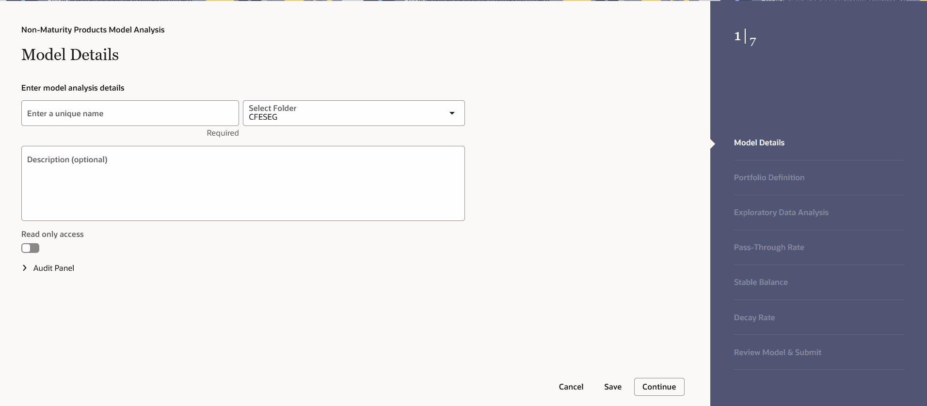

Step 1: Model Details
- From Non-Maturity Products Model Analysis ,
click Start. The Model Details page is
displayed.
Figure 6-207 Model Details
- Enter the following details:
- Name: Name of model. The Non-Maturity Products Model name should be unique. Any special characters (*, &, new line, and double quotes) are not allowed. You can enter maximum 120 characters.
- Folder: Folder Name where you want to save the model.
- Description: Description of model. The maximum limit of this field is 300 characters. Any special characters (*, &, new line, and double quotes) are not allowed. You can enter maximum 255 characters.
- Click Continue.

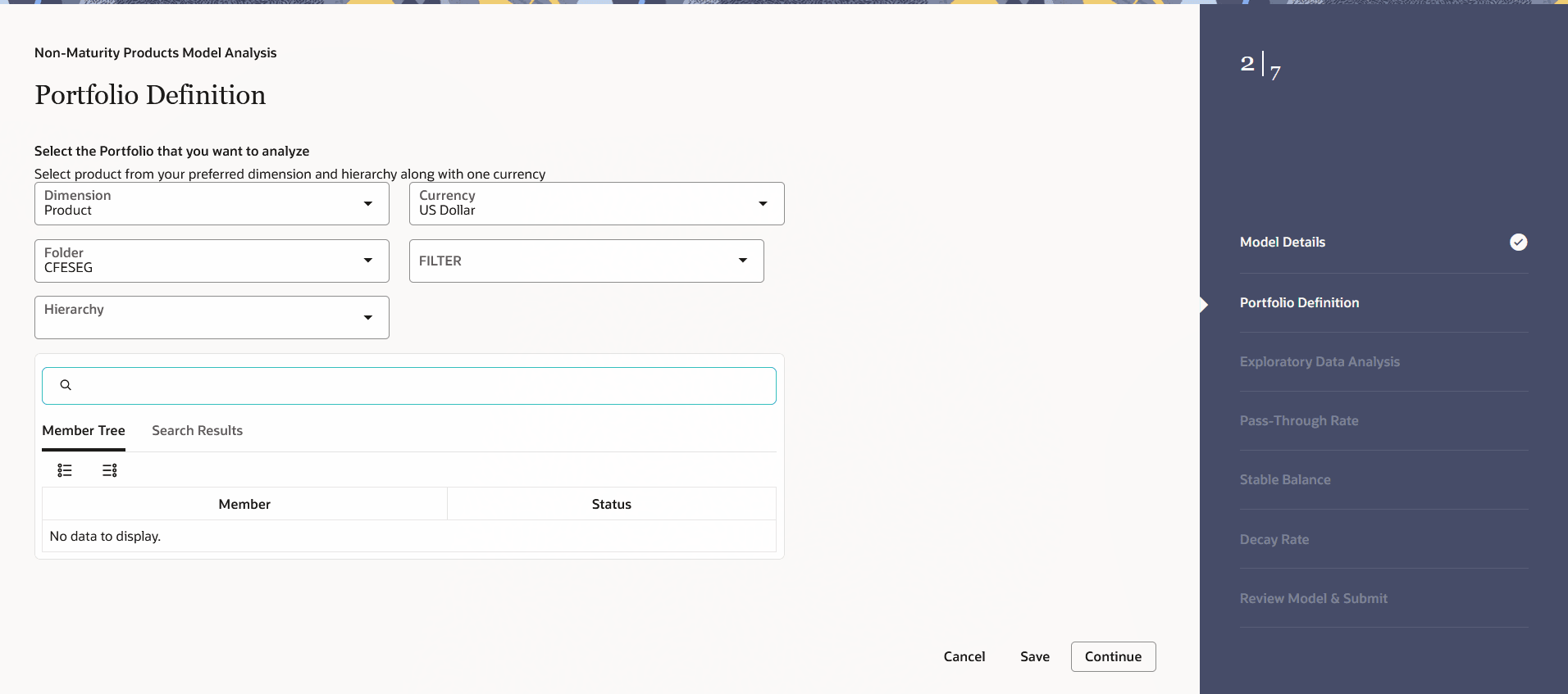

Step 2: Portfolio Selection
The Portfolio Selection window is displayed to set Portfolio.
Figure 6-208 Portfolio Selection
- Enter the following details in Portfolio Selection section:
- Dimension: Select the dimension.
- Currency: Select the currency. The Currency drop-down displays the list of active currencies.
- Folder: Select the folder from which you want to pick the Hierarchy.
- Hierarchy: You can specify some parameters at product-currency combination. Hierarchies of selected folder will be listed and you can select one from the available list of hierarchies.
- Filter: Select the filter.
- Select Product(s) from Member Tree of
Assumption Browser. The Assumption Browser has following two tabs:
Member Tree and Search Results
- Member Tree: Member Tree tab
shows the hierarchical structure and allows you to define rules
by selecting the node members from the browser. Select Node and
Click Menu icon next to it to view the available options.
Figure 6-209 Member Tree
Status of node is also displayed in Member Tree section, for example Selected, and so on. To select member hierarchy, following options are available:
- Expand self, child and descendants: Allows to expand the selected node itself along with its child and descendants.
- Expand selected member/branch: Allows to expand the selected node
- Select UnSelect self, child: Allows to unselect the selected node itself along with its child
- Select UnSelect self, child and descendants: Allows to unselect the selected node itself along with its child and descendants.
- Select Defined self, child: Allows to select the selected node itself along with its child.
- Select Defined self, child and descendants: Allows to select the selected node itself along with its child and descendants.
- UnSelect self, child and descendants: Allows to unselect the selected node itself along with its child and descendants.
Use Show Numeric Code Values (Left) icon to view the code value left to the Node name.
Use Show Numeric Code Values (Right) icon to view the code value right to the Node name.
Here, you can perform the following tasks on the selected node(s):
- Add
- Edit
- View
- Delete
- Copy
- Search Results: You can also
search the members based on the filters. This section shows the
searched node(s). To search a member, follow these steps:
- Navigate to Assumption Browser section of the Rule Definition page.
- Enter the Member ID, Name, Status, or Is
Leaf in Search Criteria.
Figure 6-210 Search Criteria
- Click Search. The searched member(s)
will be displayed in Search Results section of
Assumption Browser.
Here, you can perform the following tasks on the searched node(s):
Figure 6-211 Searching Members
- Add
- Edit
- View
- Delete
- Copy
Click Show Parentage icon to view the Parent-child Node level hierarchy details of selected Node.
- Click Continue to navigate to Exploratory Data Analysis section.

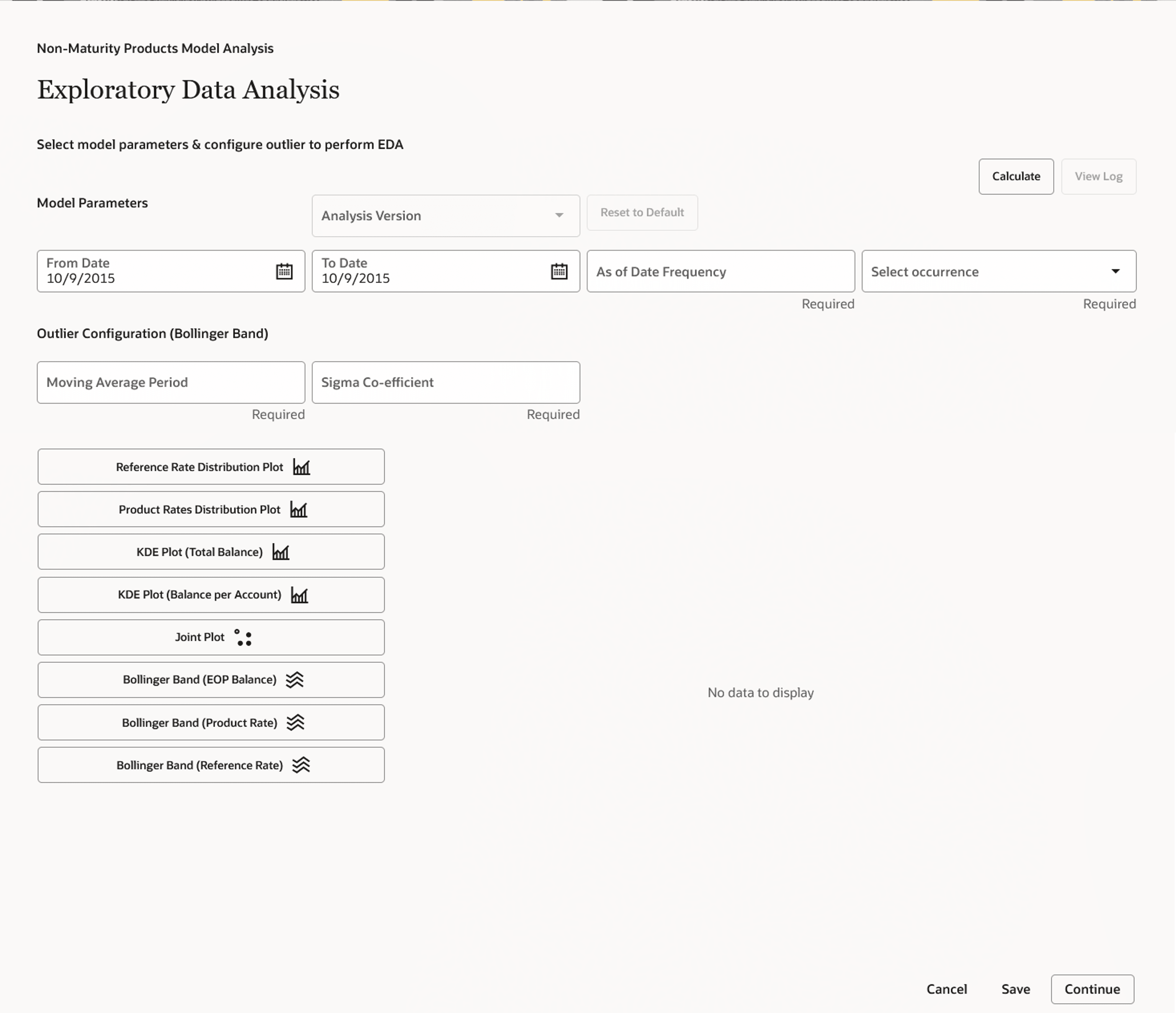

Step 3: Exploratory Data Analysis
The Exploratory Data Analysis window is displayed to define Market Rates. This window will help you to perform EDA calculations and get a glimpse of data being used for modelling.
Figure 6-212 Exploratory Data Analysis
- Enter the following details in the Exploratory Data Analysis
section:
- Model Parameters (As of Date Range):
- Analysis Versions: Shows the analysis version.
- Model Parameters (As of Date Range): You can
select a date range which will define the historical period
within which data needs to be picked for Model creation. By
default, the Date range is populated as below:
- From Date: Max (As of Date) available in Model input Table.
- To Date: Max [min (As of Date), From Date – 10 Years].
Default values are populated from
FSI_AUDIT_NM_LOAD_BATCHtable. - As of Date Frequency: The default value of this field is one month. The As of Date Frequency defines on what regular intervals, data needs to be picked from the input table. For example, you can have historical period as last three years, in those three years at what regular interval data needs to be picked up from history table that would be defined by As of Date Frequency.
- Outlier Configuration (Bollinger Band):
- Moving average period: The default value of this field is one month. The Moving Average period defines the historical term over which the moving average needs to be calculated for Bollinger band formation. This defines the period over which moving average gets calculated to create bollinger band.
- Sigma Co-efficient: The default value of this field is 1. Sigma Co-efficient defines the outliers, any number which is (sigma coefficient * standard deviation) away from the mean, will not be considered for calculations. This field accepts Integer and Decimal values in the range 0 – 10. Sigma Co-efficients helps you to define the lower and upper bands for bollinger band graphs.
- Click Calculate to perform Exploratory Data Analysis and get EDA plots. You can refresh the window using the Reset to Default button to check if the EDA is completed. When you open EDA window first time for a particular model, Version(EDA) field would not appear as there is no previous version to display. Subsequently, when first version is created and you go for second version, version (EDA) tab will start appearing with previous EDA versions. When EDA version is submitted, a message will appear with version number. A message is displayed in case last run version was failed. If run was successful and you again check this, the latest version would appear on the UI. The Reset to Default button resets the entered values to their default values.
- Click Continue to navigate to Pass-Through Rate section.

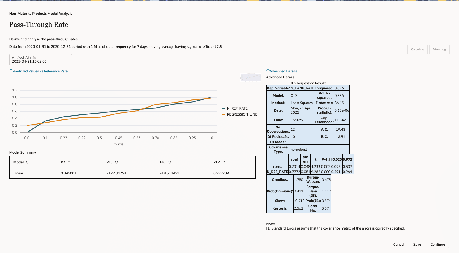

Step 4: Pass-Through Rate
Pass Through Rate is based on linear regression between market and offered rate. For current accounts, the offered rate can be zero. In such cases, the pass-through rate will also be zero, as changes in the market rate do not affect the offered rate.
Figure 6-213 Pass-Through Rate
- Click Calculate to view all the evaluation parameters and
quality plots. Pass Through Rate calculations are submitted, a message is
displayed with version number. This window shows all the model quality
parameters and graphs. At this stage, Pass through rate or beta between market
rate and deposit rate is calculated. You can zoom the graph to enhance
visibility.
The Advanced Details section helps you to evaluate the model fit.
The Model Summary section shows the details of Model parameters like R2, AIC, BIC and regression co-efficient. That is, how much change in market rate is passed on to the deposit rate.
At any stage, if you want to come out of the model analysis module, click Cancel or Save button to go back to Non-Maturity products model summary screen.
- Click Continue to navigate to Stable Balance section.
