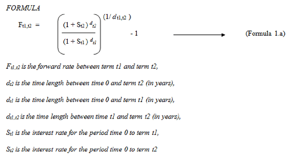

6.3.13.2 Implied Forward Rate Calculation
An Implied Forward is that rate of interest that is predicted to be the spot rate in the future.
Figure 6-159 Implied Forward Rate Calculation Formula

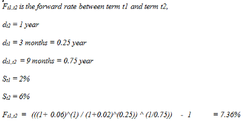

If 1 year TP Rate is 6.00% and 3 month TP Rate is 2.00% we can calculate the 3 months forward implied 9-month rate as follows:
Figure 6-160 3-month Forward Implied 9-month Rate Calculation Formula
Therefore, the market is implying that in 3 months, 9 month TP Rate will be 7.36%.

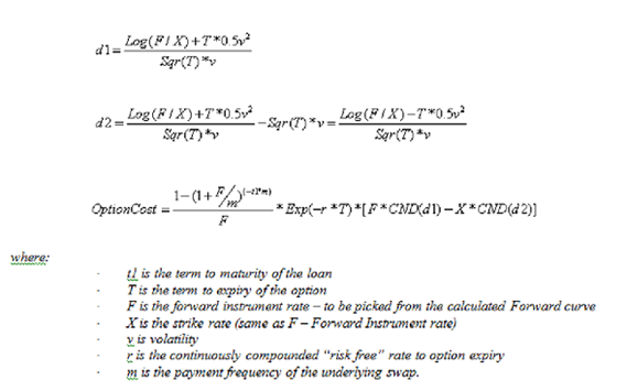

Rate Lock Option Cost Calculation: The Rate Lock Option Cost calculation uses a standard Black European swap pricing formula. This calculation is triggered by a Standard FTP Process and can be performed for both fixed-rate and adjustable-rate instruments. The following conditions must hold true for instrument records in the FSI_D_LOAN_COMMITMENTS table:
- commit_start_date <= as_of_date
- origination_date > as_of_date
Figure 6-161 Black Formula for calculating Rate Lock Option Cost

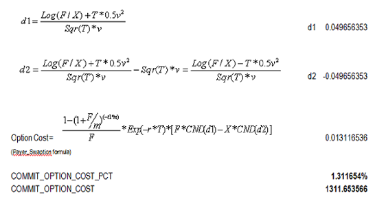

Figure 6-162 Option Cost Calculation Formula
