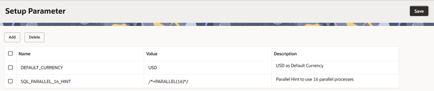

4.1.3 Setup Parameters
The Custom PLSQL Properties (Setup Parameters) user interface is used to capture placeholder configuration which might be required during the development of custom PLSQL extensions.
- To access Custom PLSQL Properties user interface, select Admin
Tools, and then select Setup
Parameters.
The Custom PLSQL Properties – Setup Parameters window is displayed.
Figure 4-1 Setup Parameter
- Click Add to define a new custom parameter and enter the
following details:
- Name: Configuration parameter key or name. Name can accept up to 200 characters.
- Value: Configuration parameter value. Value can accept up to 1000 characters.
- Description (not mandatory): Provide a description for the parameter and value added. Description can accept up to 1000 characters.
- Click Save.
- If you want to edit an already defined parameter, select the checkbox against the
Name and change the Name or
Value.
If the Name is already defined, then the system displays a message Parameter name already exists.
Example
The following is an example of how to consume the Custom PLSQL Properties parameter and its value:
- Declare a local variable (lv) in the Custom PLSQL extension definition for parameter SQL_PARALLEL_16_HINT for eg: lv_sql_parallel_16_hint
- Using a SELECT statement fetch the value of the SQL_PARALLEL_16_HINT parameter
and assign it to the local variable defined.
Example:
lv_sql_parallel_16_hint setup_master.parameter_value%TYPE; select parameter_value into lv_sql_parallel_16_hint from setup_master where parameter_name=” SQL_PARALLEL_16_HINT”;
