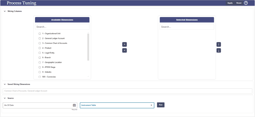

To open the Process Tuning UI:
  1. From the LHS, select Maintenance, and select Process Tuning Configuration.
    Figure 6-36 Process Tuning
    Process Tuning
  2. Select the relevant Dimensions from the Available list of Dimensions and move them to the Selected Dimensions. You can select up to six dimensions. Users are recommended to select the Product and Currency dimensions.
    You can arrange them using the top, bottom arrows.
  3. Click Apply.
    A confirmation message Slice Dimension has been saved successfully! is displayed. The selected dimensions are saved in FTP_PROCESS_TUNING_DIM_GROUP_SLICE_MAP table.
  4. Under Source part of the screen, select the following:
    • As of Date: Select the date for which you want to check the data distribution.
    • Instrument Table: The table for which you are defining the slicing dimensions.
    This enables the Run button.
  5. Click Run.
    The data distribution insights display number of records across each unique set of selected dimensions.
    After successful selection of the dimensions from the Process Tuning UI, when STP process is executed, engine will consider the selected dimensions and apply for the selected instrument tables as part of the process execution. Multiple data slices will be created across selected dimensions, all of these can be processed in parallel.
