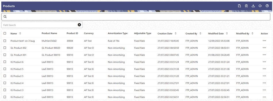

Product setup allows Administrators to define the default Product Characteristics for standard products. The Administrator will define these assumptions for Products during the application setup through the provided user interface.
The Products window shows the list of all the defined Product Characteristics for standard products and you can define/edit the properties for these standard products.
The procedure for working with and managing Products is similar to that of other Oracle Funds Transfer Pricing business rules. It includes the following steps:
  • Searching for Products
  • Creating a Product Definition
  • Viewing and Editing Product Definitions
  • Copying Product Definitions
  • Deleting Product Definitions
As part of creating and editing Product definitions, the user defines the properties for applicable products.

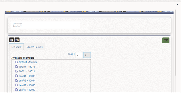

  3. Select a standard Product using the hierarchy Browser.
    Figure 6-165 Hierarchy screen
    The Hierarchy screen allows you to select the product hierarchy.

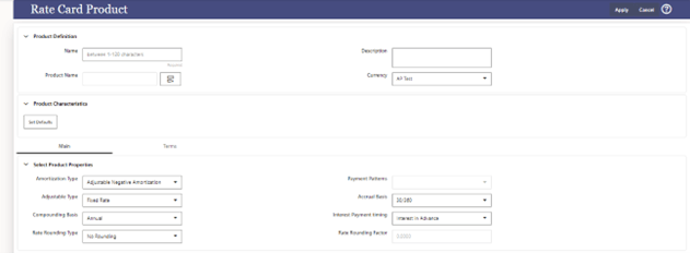

  5. Define the properties of the Product in the Main tab.
    Figure 6-166 Product Definition – Main Tab
    The Product Definition Main tab allows you to select the Product Properties.

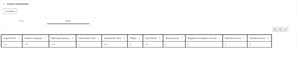

  6. Define the properties of the Product in the Terms tab.
    Figure 6-167 Product Definition – Terms Tab
    The Product Definition – Terms Tab allows you to enter and select the Terms for the product.
    Under a single product/currency selection, users may define multiple combinations of Original Term, Payment Frequency, and Repricing Frequency. This is done by adding records using the "+" icon. Multiple records are useful when generating daily pricing sheets, where the standard product has multiple terms. For example, the product could be "Term Deposits", but users may want to view the daily FTP Rates for each available term, for example, 3 months, 6 months, 12 months, 18 months, and 60 months. This example is possible by adding and defining multiple records under a single product/currency selection. For more information on the meaning of each of these fields, see the OFS Cash Flow Engine Reference Guide.
