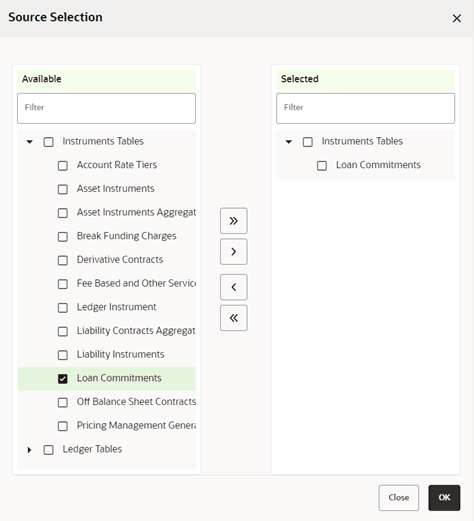

The Standard FTP Process provides setup options that allow you to Transfer Price Data in the Loan Commitments table using Forward Rates and calculate the Related Rate Lock option costs. To do this, select the Loan Commitment table under Source Selection.
The following options are available on the Calculation Selection page.
Figure 6-153 Source Selection
Source Selection

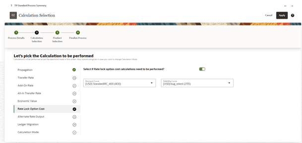

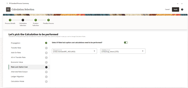

These calculation options assume the user has also selected the Loan Commitments table on the Product Selection page under Source Selection.
Figure 6-154 TP Standard Process Rule
Discount Curve: User can select any IRC as per the selected currency in user preferences, this curve will be used as risk free rate.
Volatility Curve: User needs to define volatility curve in Rate lock option volatility curve module, as per the selected currency in user preference, all the corresponding volatility curves will be listed for selection.
