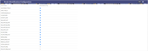

To configure the Break Identification Process:
- From the LHS menu, select Maintenance and then select
Break Identification Configuration.
Figure 5-156 Break Identification Configuration
- Select the relevant columns to identify the breaks for change in attributes.
- Click Save.
