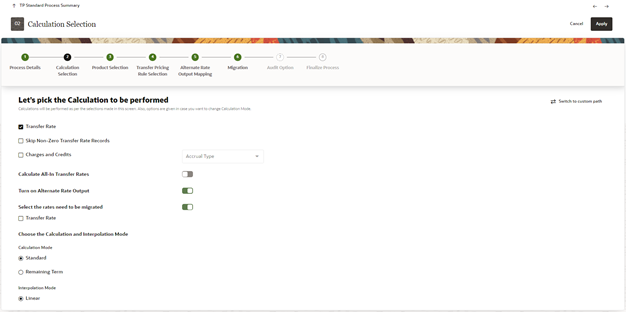

5.3.9.3.2 Calculation Selection
The Calculation Selection screen displays various calculation options that you can select. Depending on the choices you make, the progress train on the screen include few optional steps like Audit, Migration, and Prepayment Rule selection. In the below sample screen, the options Turn On Alternate Rate Output and Select the rates need to be migrated are selected; accordingly progress train on the top, starts displaying the Alternate Rate Output Mapping and Migration options as well.
You can switch the UI to a Custom Calculation Selection at any time. Clicking Switch to custom path will help you if you realize given calculation options in selected scenario, does not have all the required calculation and you like to customize the selection. When you enable the custom flow, a confirmation message is displayed to confirm the re-routing to custom flow.
Figure 5-116 Calculation Selection

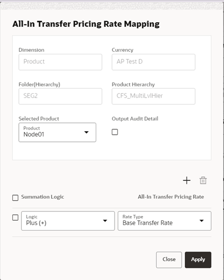

To define the All-in Transfer Rate, enable the Calculate All-In Transfer Rates toggle switch.
Select the All-in Transfer Rate check-box and then click the Settings icon to display the All-In Transfer Rate Mapping Selector window. Select the Node under Assumption Browser and click the Action icon, and then click Add. The All-In Transfer Pricing Rate Mapping window is displayed.
This window allows you to define different formula for different product and currency combinations.Figure 5-117 All-In Transfer Rate Mapping Selector
Here, you can define, different all-in TP formula for different product, currency combinations.Figure 5-118 All-In Transfer Rate Mapping
Click the + button to add a Summation Logic. Select the relevant Logic and Add-On Rate Types and click Apply.
In the Transfer Rate Mapping Selector window, select a different currency and select the Node, and then click the Action icon to add another mapping. Repeat the above steps and create the calculation logic for the selected currency.

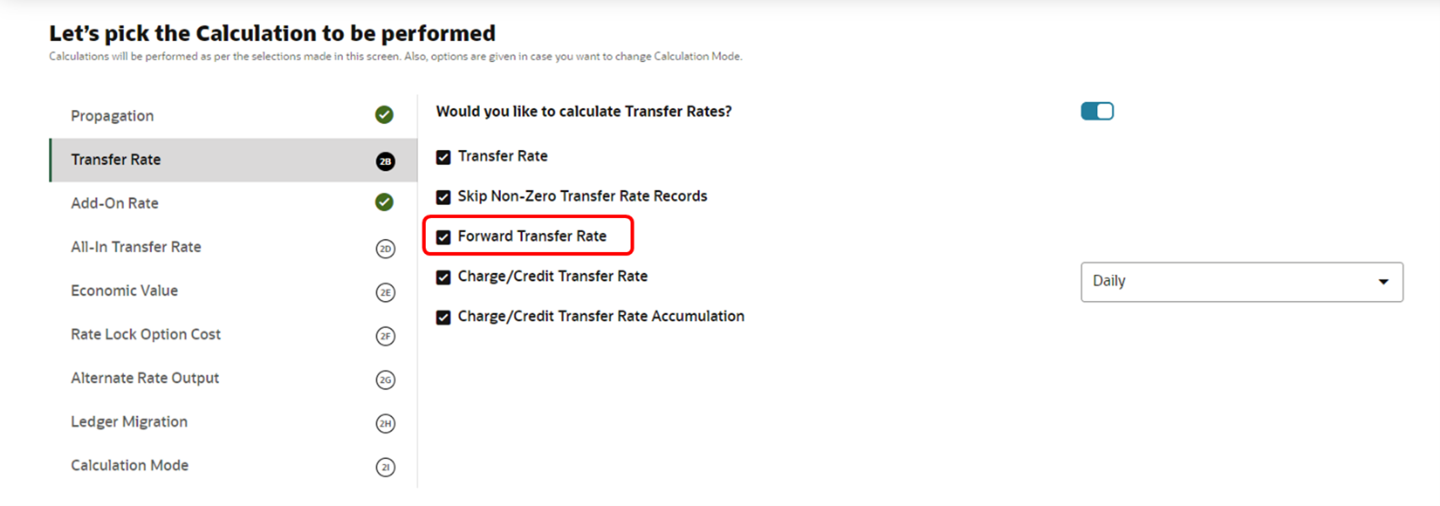

Transfer Rate Calculations based on Forward Curve
Figure 5-119 Forward Transfer Rate
