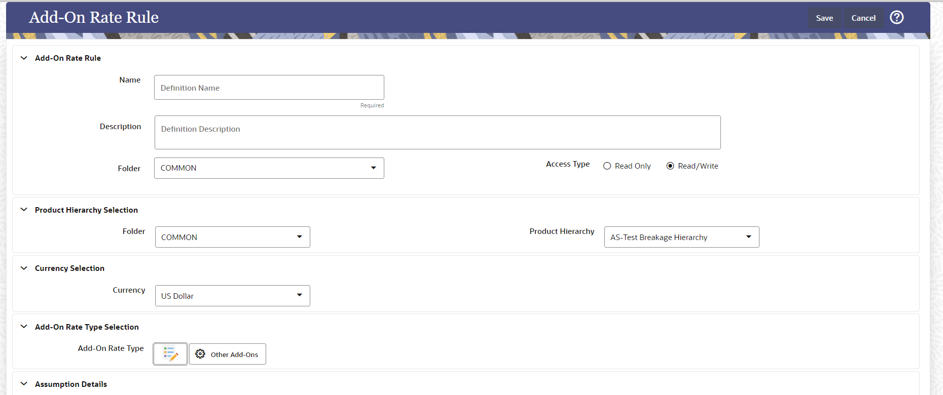

5.3.5.1 Create Add-on Rate Rule
You create an Add-on Rate Rule to define Add-on Rate Methodologies for your products.
To create the Add-on Rate Rule:
  1. From the LHS menu, select Assumption Specification, and then select Add-on Rate Rule.
    Figure 5-68 Add-On Rate Rule - Definition Mode
    The Add-On Rate Rule (Definition Mode) screen allows you to create a new Add-On Rate Rule.

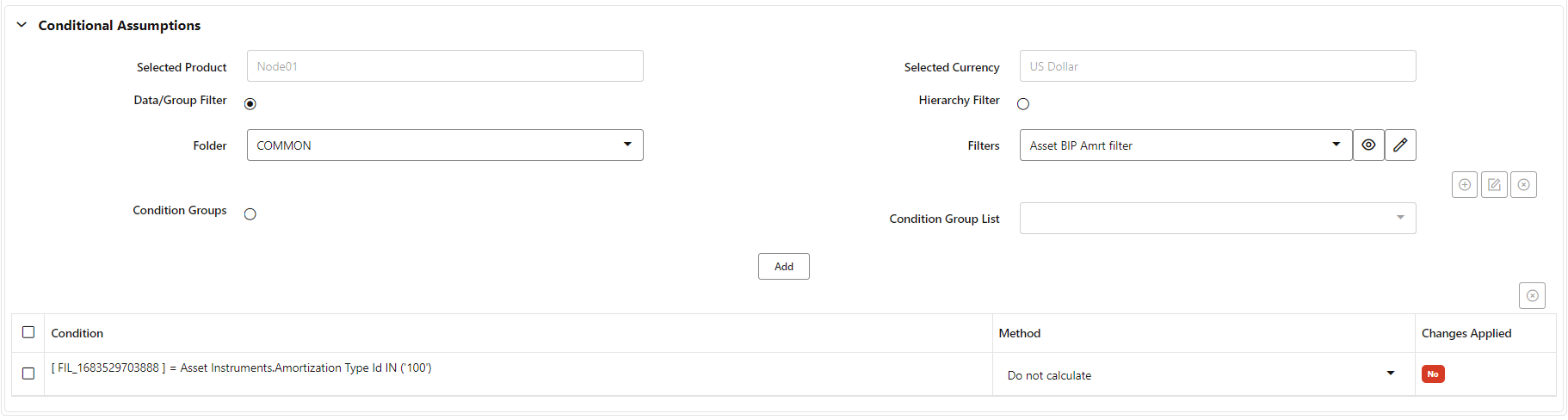

  3. Conditional Assumptions - The Conditional Assumption feature allows you to segregate your product portfolio based on common characteristics, such as Term to Maturity, Origination Date, and Repricing Frequency, and assign specific Add-on Rate Methodologies to each of the groupings.
    Figure 5-70 Conditional Assumption
    The Filters field displays the View and Edit buttons. You can verify the existing Filters by clicking the View button. Click the Edit button if you want to modify the Filter condition.
    If an instrument record does not meet any of the conditions, then the rule logic reverts to the Standard Assumption that is directly assigned to the Product/Currency combination.
