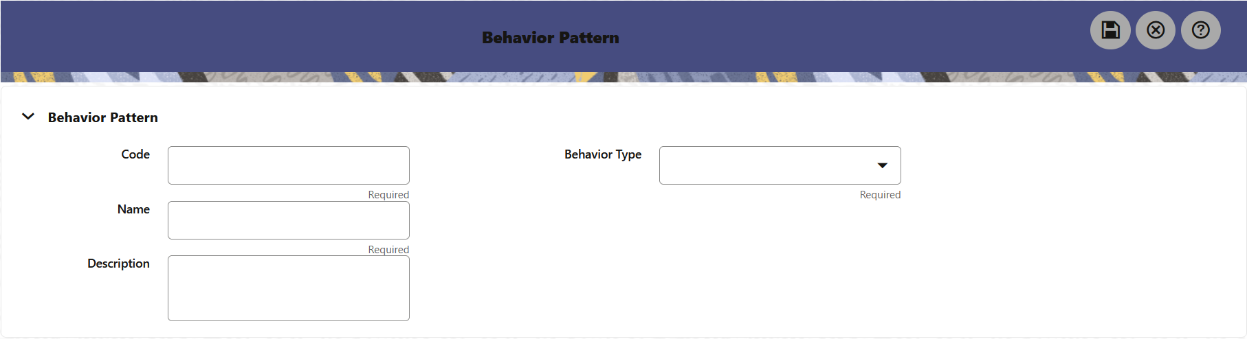

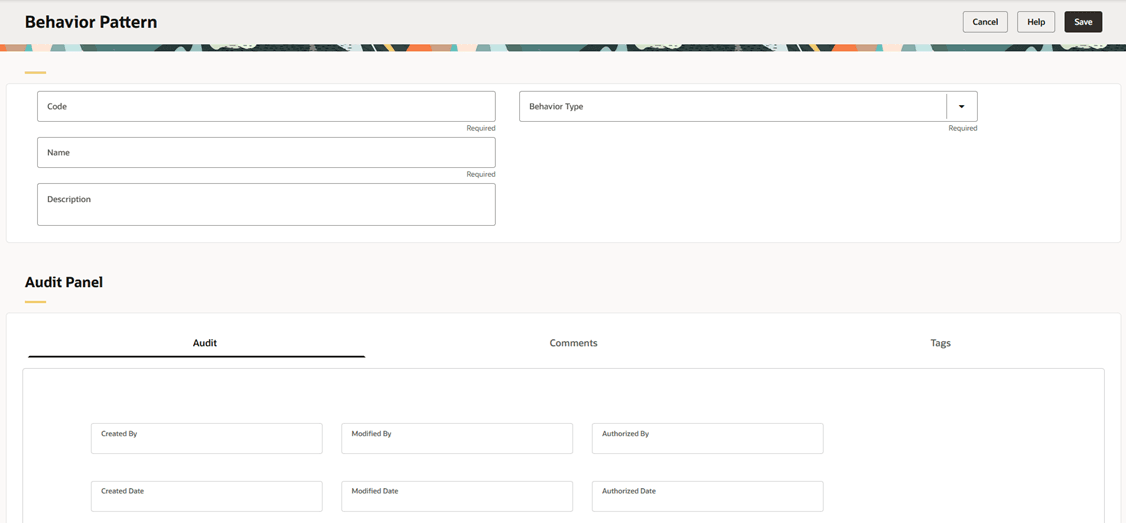

    Figure 5-13 Behavior Patterns Details Page
  3. Enter a unique Numeric Code for the new Behavior Pattern. The code is must be mapped the appropriate instrument record’s BEHAVIOUR_PATTERN_CD if Amortization Type is Behavior Pattern to connect the instrument to the appropriate pattern.
  4. Enter the Name and a Description for the pattern.
