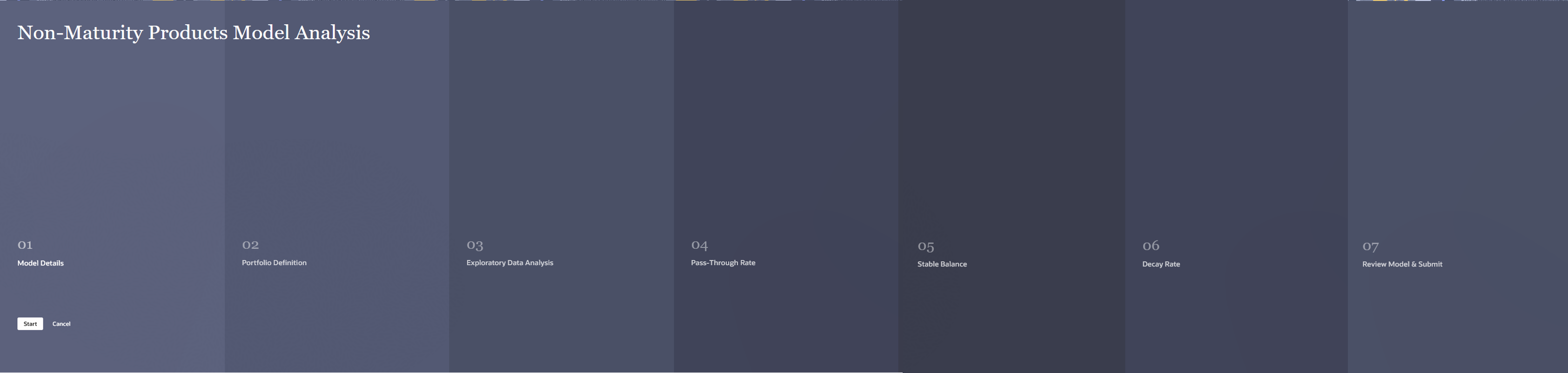

5.3.10.1 Creating Non-Maturity Products Model
To create a new Non-Maturity Products Model Analysis Rule, perform the following steps:
- Navigate to the Non-Maturity Products Model Analysis page.
- Click Add. The Create Non-Maturity
Products Model Analysis page is displayed.
Figure 5-137 Create Non-Maturity Products Model Analysis
- Follow the steps mentioned in below sections:
- Model Details
- Portfolio Definition
- Exploratory Data Analysis
- Pass-Through Rate
- Stable Balance
- Decay Rate
- Review and Submit
- Click Submit/Save after entering all details in above sections.

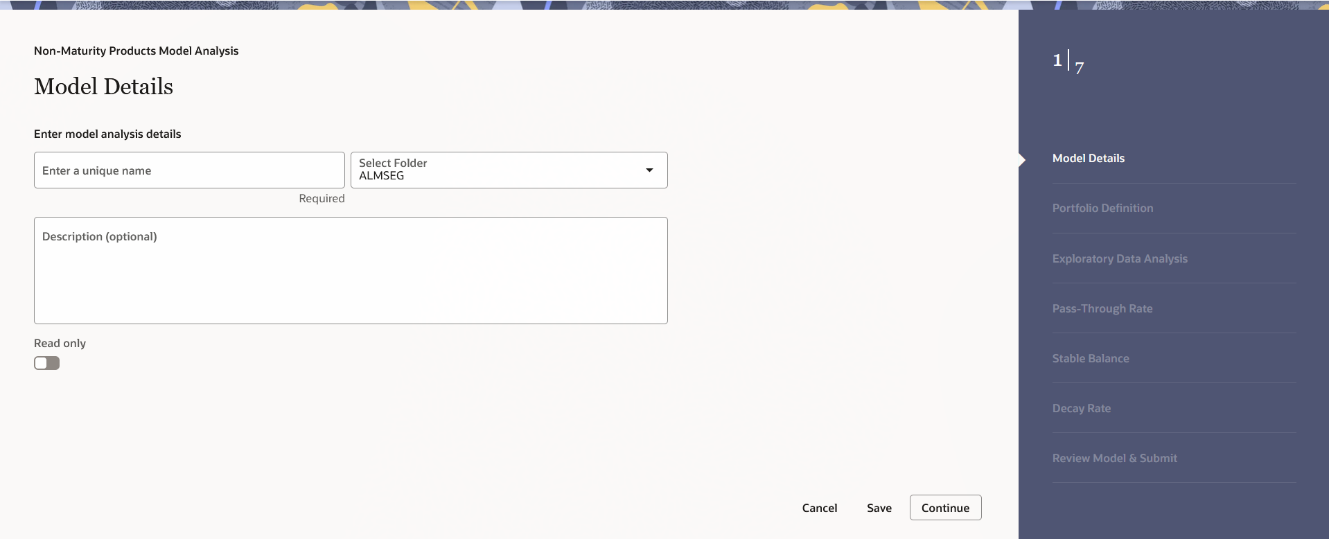

Step 1: Model Details
- From Non-Maturity Products Model Analysis ,
click Start. The Model Details page is
displayed.
Figure 5-138 Model Details
- Enter the following details:
- Name: Name of model. The Non-Maturity Products Model name should be unique. Any special characters are not applicable.
- Folder: Folder Name where you want to save the model.
- Description: Description of model. The maximum limit of this field is 300 characters. You can enter special characters in this field.
- Click Continue.

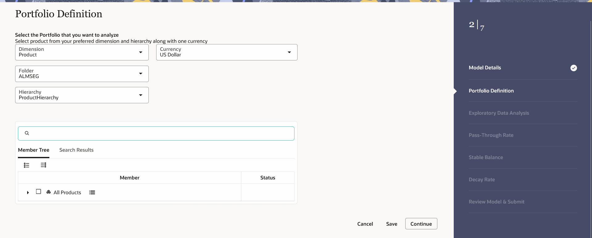

Step 2: Portfolio Selection
The Portfolio Selection window is displayed to set Portfolio.
Figure 5-139 Portfolio Selection
- Enter the following details in Portfolio Selection section:
- Dimension: Select the dimension.
- Currency: Select the currency. The Currency drop-down displays the list of active currencies.
- Folder: Select the folder from which you want to pick the Hierarchy.
- Hierarchy: You can specify some parameters at product-currency combination. Hierarchies of selected folder will be listed and you can select one from the available list of hierarchies.
- Select Product(s) from Member Tree of
Assumption Browser. The Assumption Browser has following two tabs:
Member Tree and Search Results
- Member Tree: Member Tree tab
shows the hierarchical structure and allows you to define rules
by selecting the node members from the browser. Select Node and
Click Menu icon next to it to view the available options.
Figure 5-140 Member Tree
Status of node is also displayed in Member Tree section, for example Selected, and so on. To select member hierarchy, following options are available:
- Expand self, child and descendants: Allows to expand the selected node itself along with its child and descendants.
- Expand selected member/branch: Allows to expand the selected node
- Select UnSelect self, child: Allows to unselect the selected node itself along with its child
- Select UnSelect self, child and descendants: Allows to unselect the selected node itself along with its child and descendants.
- Select Defined self, child: Allows to select the selected node itself along with its child.
- Select Defined self, child and descendants: Allows to select the selected node itself along with its child and descendants.
- UnSelect self, child and descendants: Allows to unselect the selected node itself along with its child and descendants.
Use Show Numeric Code Values (Left) icon to view the code value left to the Node name.
Use Show Numeric Code Values (Right) icon to view the code value right to the Node name.
Here, you can perform the following tasks on the selected node(s):
- Add
- Edit
- View
- Delete
- Copy
- Search Results: You can also
search the members based on the filters. This section shows the
searched node(s). To search a member, follow these steps:
- Navigate to Assumption Browser section of the Rule Definition page.
- Enter the Member ID, Name, Status, or Is
Leaf in Search Criteria.
Figure 5-141 Search Criteria
- Click Search. The searched member(s)
will be displayed in Search Results section of
Assumption Browser.
Here, you can perform the following tasks on the searched node(s):
Figure 5-142 Searching Members
- Add
- Edit
- View
- Delete
- Copy
Click Show Parentage icon to view the Parent-child Node level hierarchy details of selected Node.
- Click Continue to navigate to Exploratory Data Analysis section.

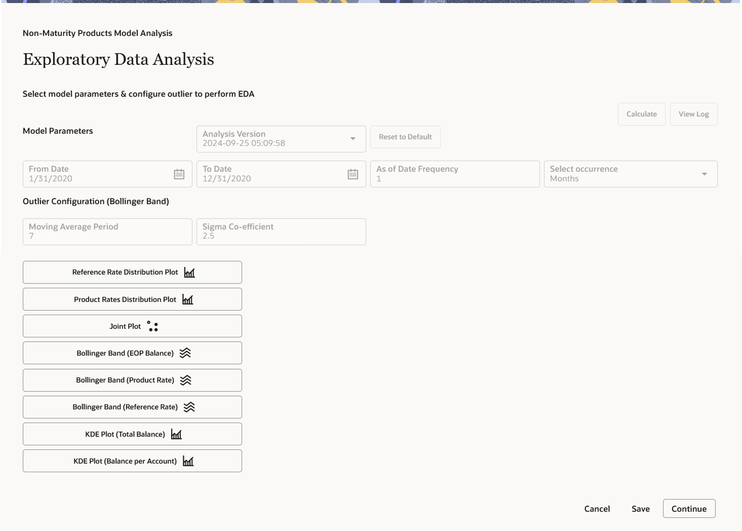

Step 3: Exploratory Data Analysis
The Exploratory Data Analysis window is displayed to define Market Rates. This window will help you to perform EDA calculations and get a glimpse of data being used for modelling.
Figure 5-143 Exploratory Data Analysis
- Enter the following details in the Exploratory Data Analysis
section:
- Model Parameters (As of Date Range):
- Analysis Versions: Shows the analysis version.
- Model Parameters (As of Date Range): You can
select a date range which will define the historical period
within which data needs to be picked for Model creation. By
default, the Date range is populated as below:
- From Date: Max (As of Date) available in Model input Table.
- To Date: Max [min (As of Date), From Date – 10 Years].
Default values are populated from
FSI_AUDIT_NM_LOAD_BATCHtable. - As of Date Frequency: The default value of this field is one month. The As of Date Frequency defines on what regular intervals, data needs to be picked from the input table. For example, you can have historical period as last three years, in those three years at what regular interval data needs to be picked up from history table that would be defined by As of Date Frequency.
- Outlier Configuration (Bollinger Band):
- Moving average period: The default value of this field is one month. The Moving Average period defines the historical term over which the moving average needs to be calculated for Bollinger band formation. This defines the period over which moving average gets calculated to create bollinger band.
- Sigma Co-efficient: The default value of this field is 1. Sigma Co-efficient defines the outliers, any number which is (sigma coefficient * standard deviation) away from the mean, will not be considered for calculations. This field accepts Integer and Decimal values in the range 0 – 10. Sigma Co-efficients helps you to define the lower and upper bands for bollinger band graphs.
- Click Calculate to perform Exploratory Data Analysis and get EDA plots. You can refresh the window using the Reset to Default button to check if the EDA is completed. When you open EDA window first time for a particular model, Version(EDA) field would not appear as there is no previous version to display. Subsequently, when first version is created and you go for second version, version (EDA) tab will start appearing with previous EDA versions. When EDA version is submitted, a message will appear with version number. A message is displayed in case last run version was failed. If run was successful and you again check this, the latest version would appear on the UI. The Reset to Default button resets the entered values to their default values.
- Click Continue to navigate to Pass-Through Rate section.

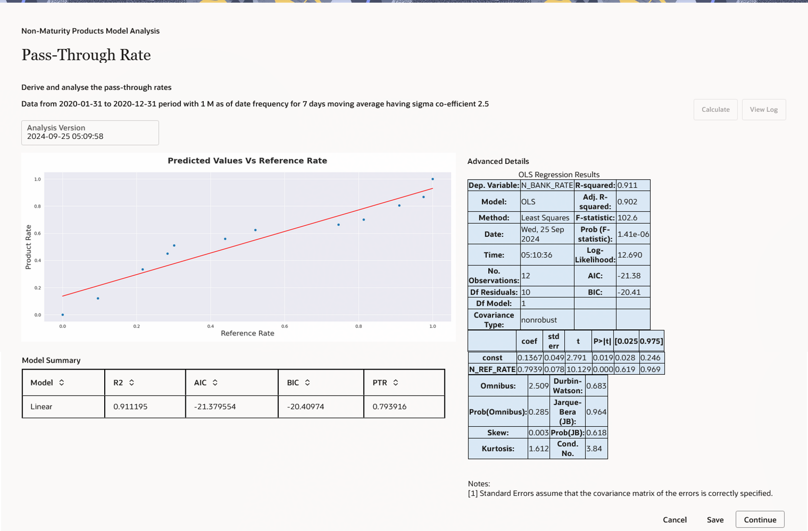

Step 4: Pass-Through Rate
Pass Through Rate is based on linear regression between market and offered rate. For current accounts, the offered rate can be zero. In such cases, the pass-through rate will also be zero, as changes in the market rate do not affect the offered rate.
Figure 5-144 Pass-Through Rate
- Click Calculate to view all the evaluation parameters and
quality plots. Pass Through Rate calculations are submitted, a message is
displayed with version number. This window shows all the model quality
parameters and graphs. At this stage, Pass through rate or beta between market
rate and deposit rate is calculated. You can zoom the graph to enhance
visibility.
The Advanced Details section helps you to evaluate the model fit.
The Model Summary section shows the details of Model parameters like R2, AIC, BIC and regression co-efficient. That is, how much change in market rate is passed on to the deposit rate.
At any stage, if you want to come out of the model analysis module, click Cancel or Save button to go back to Non-Maturity products model summary screen.
- Click Continue to navigate to Stable Balance section.

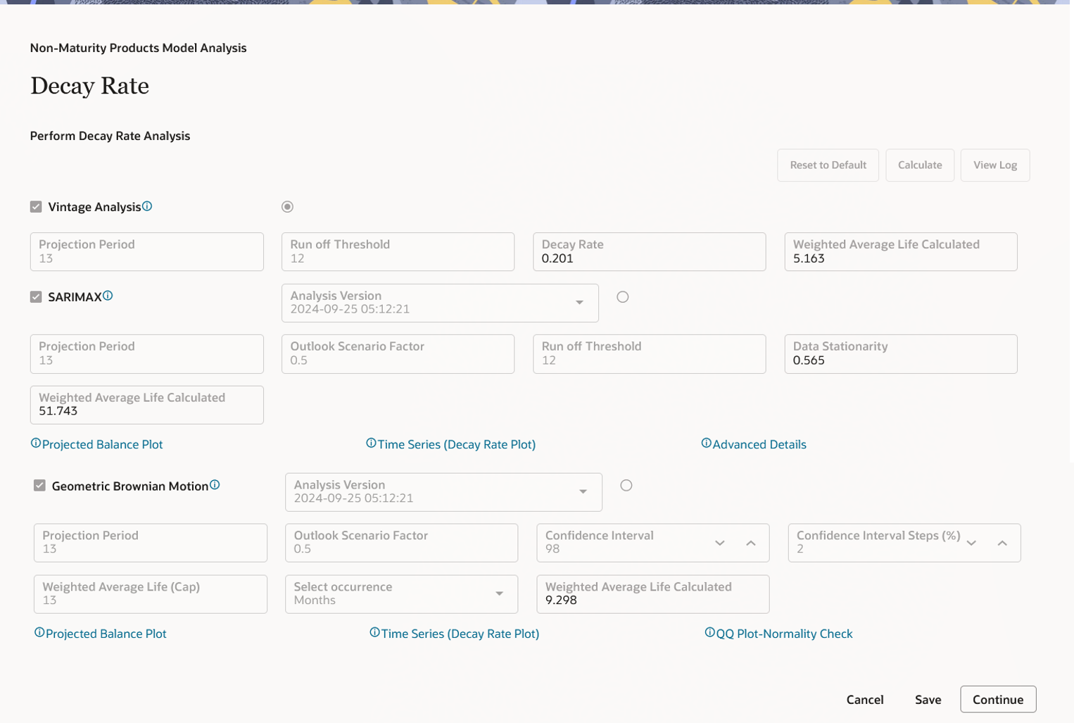

Step 6: Decay Rate
For Decay rate calculations, you can select any one of following three approaches:
- Vintage Analysis
- SARIMAX
- Geometric Brownian Motion
Figure 5-146 Decay Rate
- Select the Decay Rate method:
Vintage Analysis: This method calculates one decay rate value as
per the various vintages and regular intervals over which data is being
picked for the defined portfolio. The same decay rate is applicable to
the whole projection period.
The vintage run-off model aims to categorize deposit balances based on historical tranches, referred to as vintages. A vintage comprises all individual accounts for a non-maturing deposit account type that were opened within a specific time bucket, such as a month or week. Behavioral characteristics are applied to each vintage by calculating the monthly decay within each vintage. Run-off calculations are performed across data points and account origination buckets, with the final decay rate being the average of both dimensions for the selected portfolio.
Select the Vintage Analysis check-box if you want to include it in the calculation, or leave it unchecked to exclude it. Vintage analysis requires account-level data for the entire historical period, which may not be available initially, so you can opt to bypass this method. Other methods use portfolio or cohort-level data, which is generally easier to obtain. By default, the check-box is unchecked, indicating that this model is not part of the processing. You can set the projection period according to your needs.
- SARIMAX: This method creates a future balance profile
based on historical balances, along with Run-off volatility multiplied
by the Outlook scenario factor (default 1). Based on balance Run-offs, a
decay profile is created.
Among the various approaches, the SARIMAX model (Seasonal Autoregressive Integrated Moving Average with exogenous variables) is a powerful tool for modeling and forecasting trends and seasonal variations in time series data. It also incorporates external variables to enhance prediction accuracy. This model is part of the ARIMA family and is built on three key components: autoregression (AR), moving average (MA), and integration (I).
- Autoregression (AR) uses past values of the time series to predict the current value.
- Moving average (MA) accounts for past prediction errors, applying a linear regression on the last "q" error values to forecast the present.
- Integration (I) makes the data stationary by accounting for differences between consecutive observations.
For data with seasonal variations, the SARIMA model is used, adding the "Seasonal" component to ARIMA, which captures patterns that repeat at regular intervals. Based on the decay rate in each period, the weighted average life is calculated by multiplying the run-off matrix with the time series.
- Geometric Brownian Motion: Based on balance Run-off
volatility and your inputs like confidence interval and outlook scenario
factor, the Decay Rates are calculated for each subsequent period in
projection period and decay profile is created. Based on the Decay Rate
Profile, Run-offs would be calculated and finally, a balance profile
will be created which will in turn help to calculate WAL.
Based on the Decay Rates profile, the model will do Weighted Average Life (WAL) calculations. If the WAL exceeds the specified regulatory cap, you can set a confidence interval range and steps (defaulting to 5%) for adjusting the confidence interval in each calculation. For example, if the range is 80-95%, the system will generate a Decay Rate Profile at 80%, 85%, 90%, and 95% intervals. Through an iterative process, it will attempt to calculate a Decay Rate Profile that brings the WAL within the regulatory cap set by the user.
If in a given confidence interval range, WAL is still more than regulatory WAL (Cap), a simple linear Decay Rate Profile is created.
The run-off threshold is a user-defined input that sets the minimum balance at which WAL calculations will stop, assuming the balance has reached zero at that point.
When this section is launched first time and you click Calculate, Decay Rate is calculated for all three methods, Vintage Analysis, SARIMAX, and Geometric Brownian Motion. -
