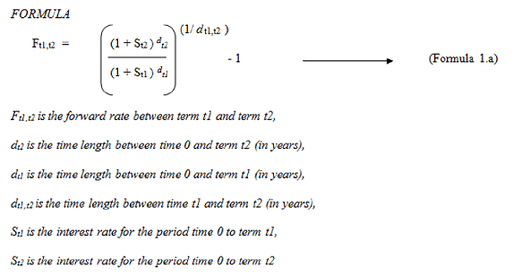

5.3.14.2 Implied Forward Rate Calculation
An Implied Forward is that rate of interest that is predicted to be the spot rate in the future.
Figure 5-170 Implied Forward Rate Calculation Formula
This illustration shows the formula to calculate the Implied Forward Rate Calculation.

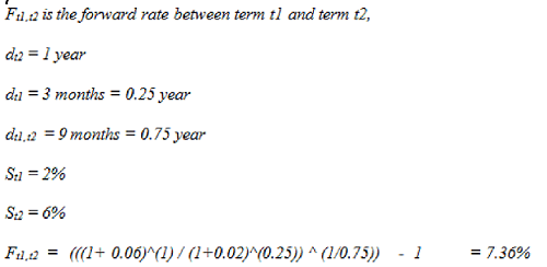

If 1 year TP Rate is 6.00% and 3 month TP Rate is 2.00% we can calculate the 3 months forward implied 9-month rate as follows:
Figure 5-171 3-month Forward Implied 9-month Rate Calculation Formula
This illustration shows the formula to calculate 3-month Forward Implied 9-month Rate Calculation.
Therefore, the market is implying that in 3 months, 9 month TP Rate will be 7.36%.

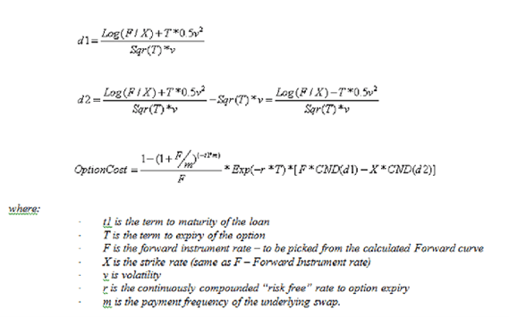

Rate Lock Option Cost Calculation: The Rate Lock Option Cost calculation uses a standard Black European swap pricing formula. This calculation is triggered by a Standard FTP Process and can be performed for both fixed-rate and adjustable-rate instruments. The following conditions must hold true for instrument records in the FSI_D_LOAN_COMMITMENTS table:
  • commit_start_date <= as_of_date
  • origination_date > as_of_date
Figure 5-172 Black Formula for calculating Rate Lock Option Cost
This illustration shows the formula to calculate Black Formula for calculating Rate Lock Option Cost.

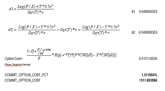

Figure 5-173 Option Cost Calculation Formula
This illustration shows the formula to calculate the Option Cost.
