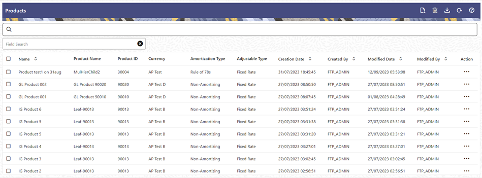

Product setup allows Administrators to define the default Product Characteristics for standard products. The Administrator will define these assumptions for Products during the application setup through the provided user interface.
The Products window shows the list of all the defined Product Characteristics for standard products and you can define/edit the properties for these standard products.
The procedure for working with and managing Products is similar to that of other Oracle Funds Transfer Pricing business rules. It includes the following steps:

Figure 5-174 Products screen

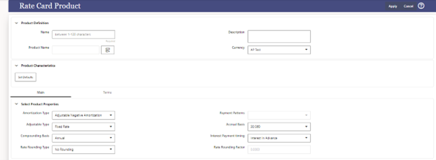

The definition of Product is a part of the Create or Edit Product Definition Page. When you click Apply or Save on the Create Product Definition page, the product definition is saved and the Product will be displayed on the Product summary page.
Only those Products, which are defined by the Administrator, will be included in the daily Rate Card Process and similarly, only defined products will be available to end-users for Rate Card reporting.Figure 5-175 Product Definition screen

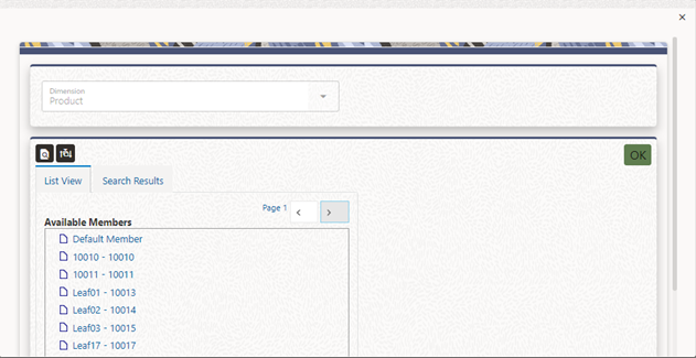

- Select a standard Product using the hierarchy Browser.
Figure 5-176 Hierarchy screen
- Select the corresponding currency.
- Define the properties of the Product in the Main tab.
Figure 5-177 Product Definition – Main Tab

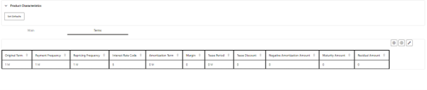

- Define the properties of the Product in the Terms tab.
Figure 5-178 Product Definition – Terms Tab
Under a single product/currency selection, users may define multiple combinations of Original Term, Payment Frequency, and Repricing Frequency. This is done by adding records using the "+" icon. Multiple records are useful when generating daily pricing sheets, where the standard product has multiple terms. For example, the product could be "Term Deposits", but users may want to view the daily FTP Rates for each available term, for example, 3 months, 6 months, 12 months, 18 months, and 60 months. This example is possible by adding and defining multiple records under a single product/currency selection. For more information on the meaning of each of these fields, see the OFS Cash Flow Engine Reference Guide. - Click Apply.
