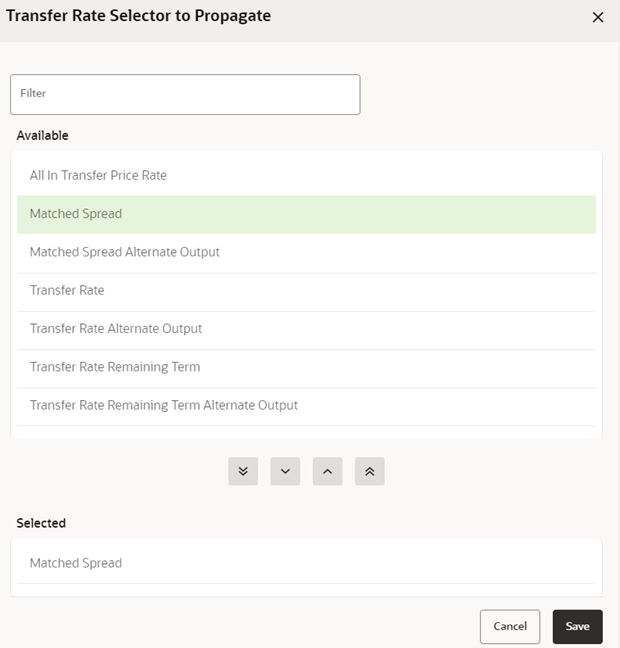

- Transfer Rate Propagation: Select Transfer Rate
Propagation and click the Settings icon to
select the Rate need to be propagated.
Figure 5-130 Transfer Rate Selector to Propagate
- Select the relevant option for the Transfer Rates that you want to propagate from the Available block and use the Move buttons to move them to the Selected block.
- Click Save.
