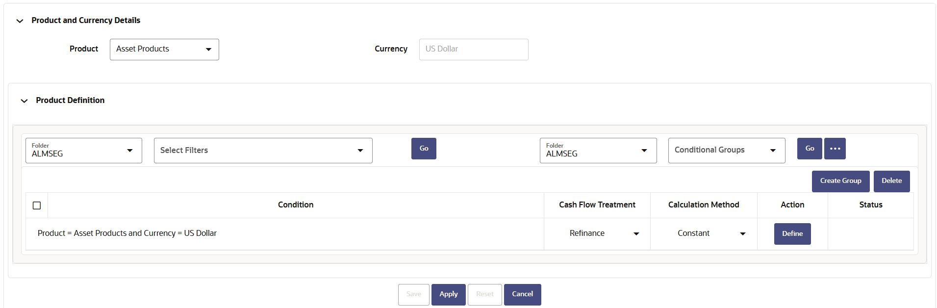

For Cash Flow Engine Cloud Service, this is applicable only for Product/Currency combination.Conditional Assumptions can be applied only to detailed account records (data stored in the Instrument Tables).

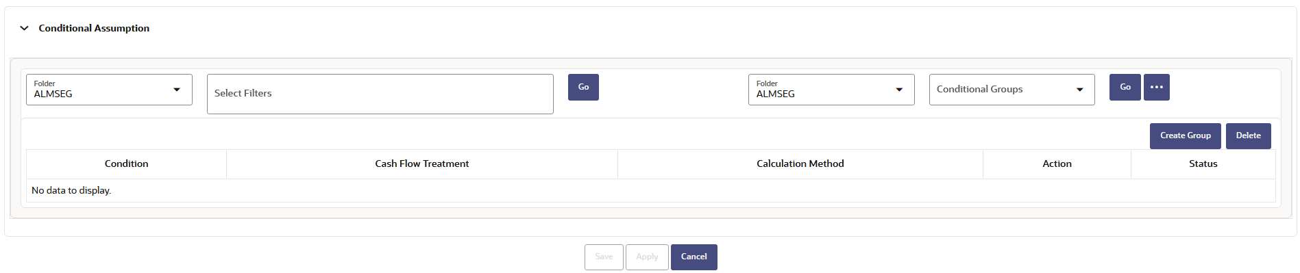

- Navigate to Conditional Assumptions section.

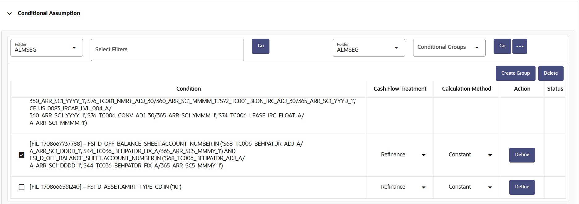

Figure 6-101 Conditional Assumption
Figure 6-102 Conditional Assumption
- Select the Filter Folder and Filter, then click Go. The condition is displayed based on selected filter.
- Here, you can select either group of conditions using Conditional
Group or Individual condition using the filter section.

- Select Cash Flow Treatment as Curtailment or Refinance.
- Select Calculation Method as Constant, Prepayment Model, PSA, or Arctangent..
- Click Define.
Figure 6-103 Conditional Assumption

- Define Prepayment rule and Seasonality, and then click Apply.
The status of condition assumption is updated as
Defined.

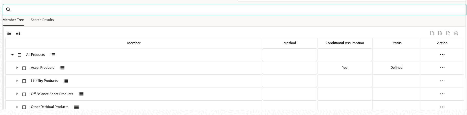

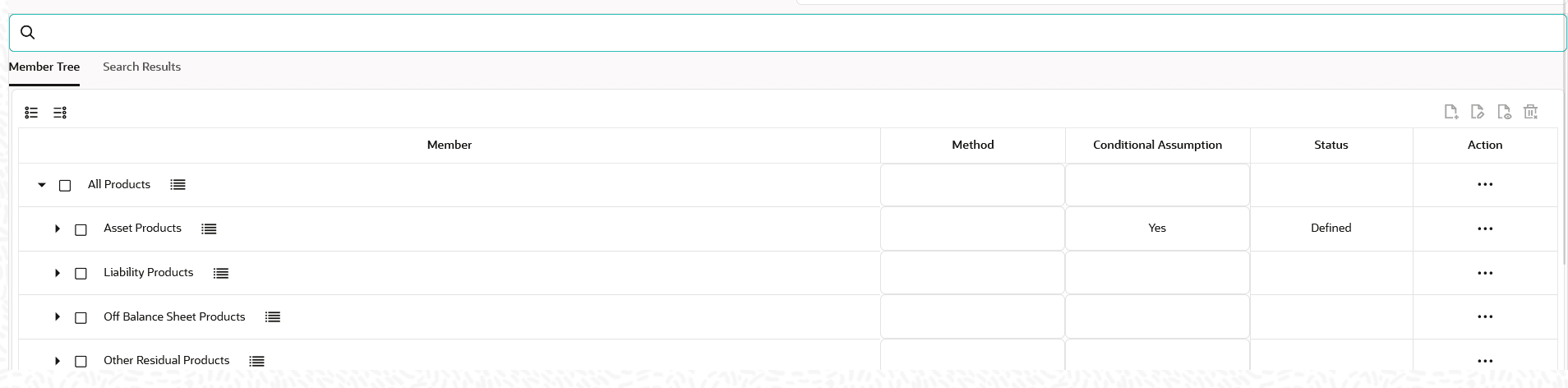

You can edit the condition using Edit. - Click Save. The status of conditional assumption is also
updated in Assumption Browser.
Figure 6-104 Status of Conditional Assumption
