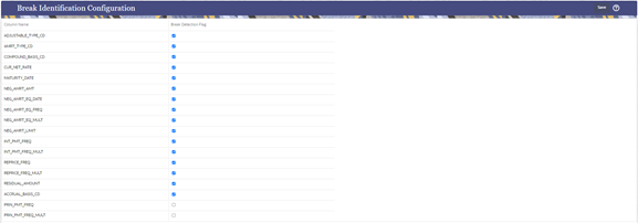

To configure the Break Identification Process:
  1. From the LHS menu, select Maintenance and then select Break Identification Configuration.
    Figure 6-140 Break Identification Configuration
  2. Select the relevant columns to identify the breaks for change in attributes.
  3. Click Save.
