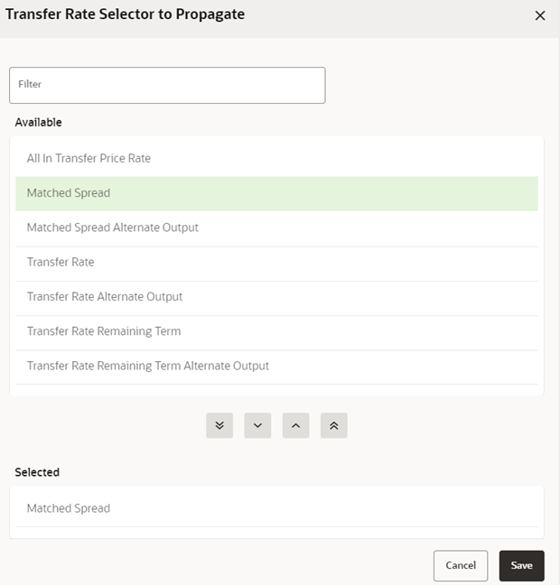

    2. Transfer Rate Propagation: Select Transfer Rate Propagation and click the Settings icon to select the Rate need to be propagated.
      Figure 6-134 Transfer Rate Selector to Propagate
      For Duration and Average Life Propagation, you can use the Task component "FTP Propagation.
      1. Select the relevant option for the Transfer Rates that you want to propagate from the Available block and use the Move buttons to move them to the Selected block.
      2. Click Save.
