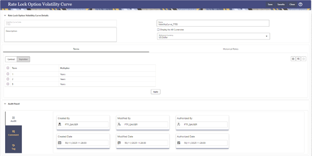

To set up a volatility curve, while defining a new Interest Rate Curve, select the check box – 'Volatility Curve'.
Terms tab: For a Volatility Curve, the Terms tab displays two types of terms – The Contract Term (Loan Term) and the Expiration Term (Rate Lock (option expiry) Term). Users must provide the volatility inputs for all combinations of Contract Term and Expiration Term.

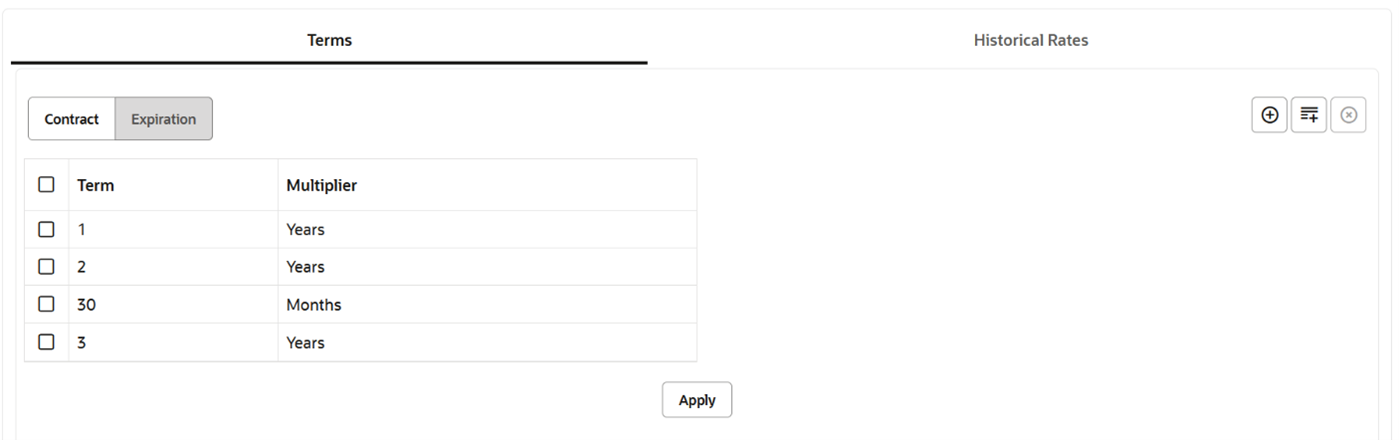

  • Terms tab - Contract Term: Add rows and input terms for the number of required Loan Terms. These are the maturity term of the loan. Select APPLY to save the data.
    Figure 6-151 Terms Tab – Contract Term
    This screen allows you to define the Contract Term.

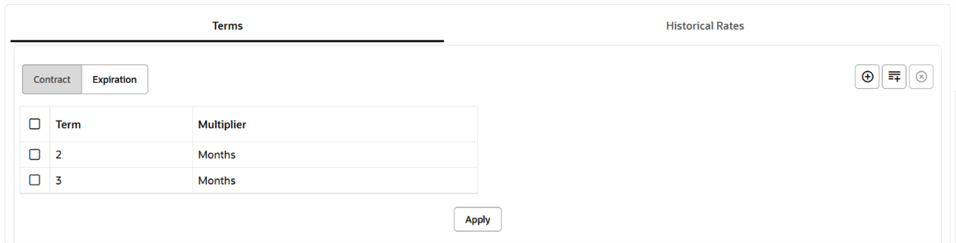

  • Terms Tab – Expiration Term: Add rows and Input Terms for the number of required Expiration Terms. These correspond to the number of Rate Lock Terms offered. Select APPLY to save the data.
    Figure 6-152 Terms Tab – Expiration Term
    This screen allows you to define the Expiration Term.

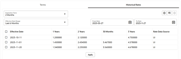

Historical Rates tab: After defining and applying the volatility curve dimensions, navigate to the Historical Rates tab and input the volatility rates for each combination of the loan term and rate lock term and for each effective date that you wish to store historical volatility data.
Figure 6-153 Historical Rates Tab
This screen allows you to input the volatility rates for each combination of the loan term and rate lock term and for each effective date that you wish to store historical volatility data.
